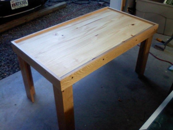

This was one of my first projects. My general way of working is to find a few plans / articles about a project and apply them to my overall vision/idea. I made our Son's table from red oak, plywood, glue, and decking screws. I counter sunk the screws and covered them with wood plugs. It turned out pretty good for my first real project. It is definitely durable. I will paste the links to my resources below. I basically followed the plan in the youtube video. I also posted a picture of the table I made. Let me know if you have specific questions and I will try to help.
My dimensions were 2' x 4'. I would adjust height of legs by your child's size and expected growth over the next year.
