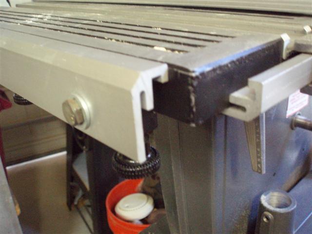

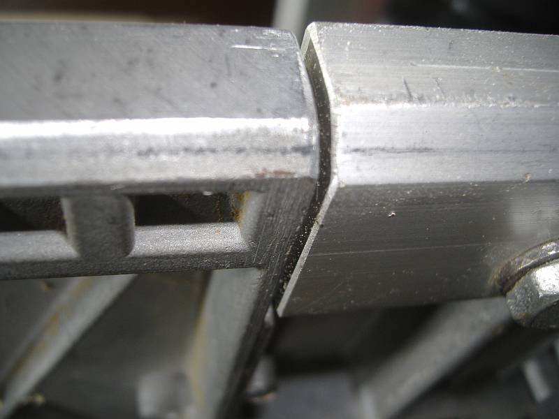

Now we finally get to some pictures. The older extension table was a cast part, this is an image of the front edge for your reference.
[ATTACH]10073[/ATTACH]
The main table has front rail part that looks like this:
[ATTACH]10074[/ATTACH]
When mounted it looks like this (sorry for the odd angle):
[ATTACH]10075[/ATTACH]

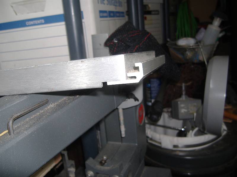

When the new wider table was introduced it to came with the extruded part as seen here:
[ATTACH]10076[/ATTACH]
Which ever rail you have the rip fence doesn't care, they all work interchangeability.
When the front of the main table is aligned with the extension table the rip fence it will squaring it self to that front rail and in fact should be able to mount right over the junction of the two and still function.
In addition the sides of the extension table should mount flush with the main table. It should be aligned so that a straight edge sitting on the main table will show the extension table to be the same height all along the way and flat to the main table. If you have the old bolt arrangement or have installed studs you need to adjust it so it is right.
Now the problem that can show up is after adjusting the extension table on the left side it may not be the same if mounted to the right or the other way round. Thus the reason I have a left hand side extension table and a right side extension table.
One additional check you can make for extension tables on the right is to lower the extension table so the main table can slide over it. Attach the rip fence to the extension table and slide the main table up against the rip fence, the should align.

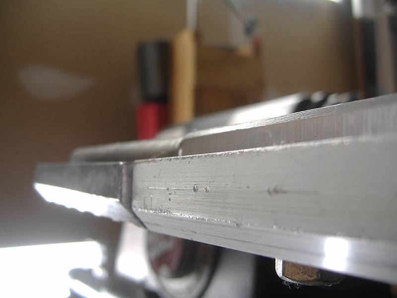

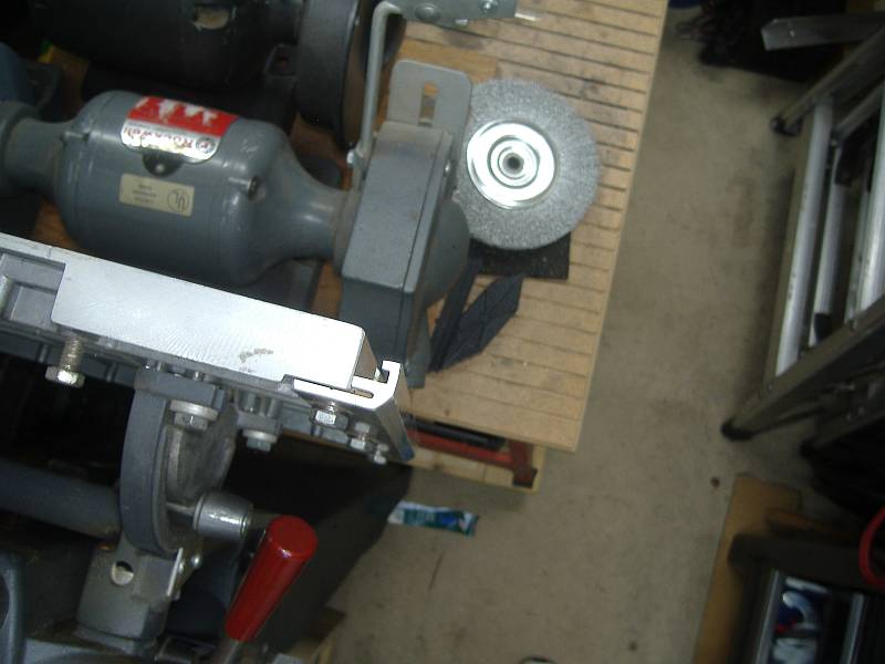

Thank you very much, Ed. I think I understand and I believe that I have confirmed that the front edge of the main 500 table and that from the bandsaw (rear edge) are very, very similar if not exactly the same.
[ATTACH]10092[/ATTACH]
- Rear Rail Shopsmith Bandsaw.JPG (44.32 KiB) Viewed 5168 times

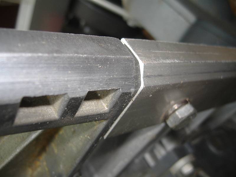

Some Mark 5 information!
Mark 5's produced before Shopsmith Inc. had the narrow extension tables that Ed showed in the first pix. Those had the fence reference surface cast in(then milled slightly). They do not have the same dimensions as the extrusion. Nor do they all have the same dimensions.
[ATTACH]10112[/ATTACH]
This in my main table and extension table purchased new in 1963
This is why I believe there was NO intent to make a smooth transition of sliding the rip fence across that gap nor to permit securing the rip fence across it.
[ATTACH]10113[/ATTACH]

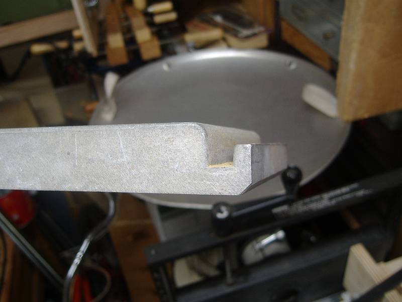

These are three other narrow extension tables acquired at various times. Notice the wide dimensional variation of the beveled surface the fence references when attaching/squaring up. The only constant is the beveled surface being flat across the front of the extension table.
The Greenies and early(3/4hp gilmer) goldies(I think) main table also had the cast in front surface, not the extrusion.

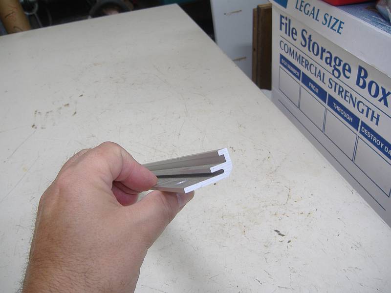

Yes Dusty the extrusions on the bandsaw for the ripfence and the table extension ARE the same as the wide extension table and pre 510/520 main tables. Do not know about '505'.

I have been unclear re the '505'! Thanks for 'defining it'. All I really remembered was the table size was increased. Wondered about the fence etc. Now it comes together!!! Thanks again!!!SDSSmith wrote:Not sure what you are referring to with the 505, but the 505 is/was just a 510 without floating tables, table tubes and telescoping legs. It replaced the 500 as the entry level machine.
Based on the images posted here and in the other related thread, I would conclude that the bevel is the critical reference surface for rip fence alignment.
If I had a serious alignment problem, I might well start by ensuring that this bevel was the same angle on all of my tables and that it matched the mating beveled surface on the rip fence.
That beveled surface is indeed the reference surface for rip fence alignment.dusty wrote:Based on the images posted here and in the other related thread, I would conclude that the bevel is the critical reference surface for rip fence alignment.
If I had a serious alignment problem, I might well start by ensuring that this bevel was the same on all of my tables and that it matched the mating beveled surface on the rip fence.
As long as that surface is flat across the front, that is sufficient. Then the fence may be attached to the extension table and the table squared to the main table miter gauge slot by referencing the edge of the fence(just as the main table miter gauge slot was used to adjust the fence alignment initially).
There is no need for the surfaces to 'match' as long as each beveled surface properly aligns the rip fence properly. There is too much dimensional variation between tables to allow the fence to either slide across the gap or bridge it when secured.
It may be possible with the extrusions on the wide extension table, but hardly worth the effort IMHO. With the wide extension table there should be no need to do so.

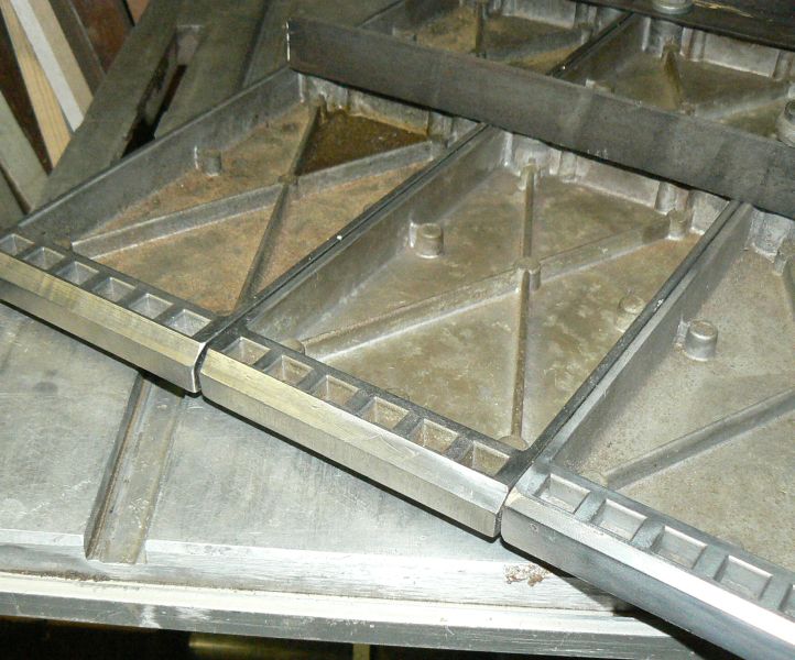

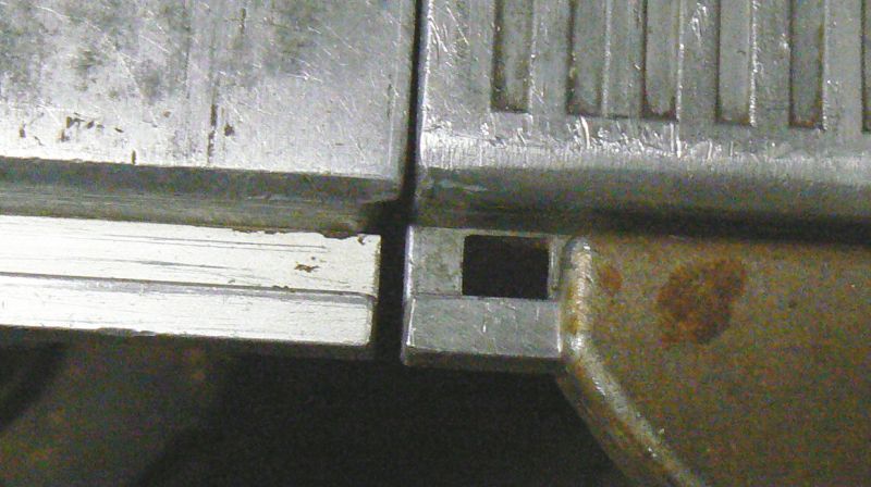

OK I went into the jungle that is my garage to retrieve my box of 500 parts to find the original small tables I have. These have been off the machine for a lot of years as I upgraded to the wider tables when they came out (any one know the date??). I also pulled out 2 more, one that came with another machine (the machine was from 1979 but who knows about the table) the second was purchase for the tube parts and I have no history to recall on that one.
Three of these are the same and one is different. The different one has the front angle machined with a larger amount of surface area, it looks a lot different then the others. The three, two from my original 1976 model and the one that came with the 1979 machine all have that area a lot smaller.
When matched with my original table it is clear that the wear lines are in alignment with the three. When in use the rip fence slides nicely over the seam and locks squarely anywhere over the joint the same as if the joint were not there. Now I only did this with one of the three and I would have done the others but it is a lot of work getting everything mounted and aligned and all for nothing more then posting here as I don't plan to ever use the small tables again.
[ATTACH]10114[/ATTACH]
The odd table does NOT align well. If you get the angle portion to match then the front are not aligned and with the fronts aligned the position of the angle is wrong. It appeared clear that these two would not play well together. When the angle parts are aligned the wear marks also aligned so since I had nothing to loose except a bit more time I went ahead with the rip fence tests anyway. When the angles align there is still space in the rip fence head and it doesn't bottom out... so far so good. Well quite unexpectedly the rip fence slides along and seems to work just fine.
[ATTACH]10115[/ATTACH]
[ATTACH]10116[/ATTACH]
I would suggest further testing from those of you who have the hardware along these lines. I'm finished and the hardware I have is ready to be put away again. Can't say you will have the same results, but it looks to be worth you checking your hardware if you want.
BTW the angles were aligned using a ruler edge and trying to have 3 hands to keep things in place so good luck with that too.
I would really like to here from some others after they check what they can do. I know I learned something new today.
