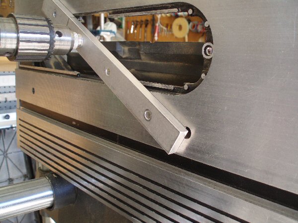

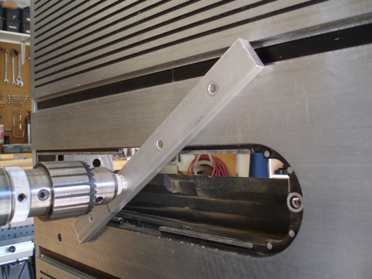

I took a couple of your suggestions as offered in this thread and rechecked my table. I have always been a little bothered by inaccuracies created in drill press mode. I found that it was not as perfectly aligned as I thought. It was right on corner to corner in one direction but significantly off corner to corner on the other diagonal.
Shims. I gotta install shims. Easiest way to do that is see what is there and compare to what appears to be required.
Guess what - no shims. Did I ever do this alignment????
Based on measurements taken, I decided to put two shims on each of the studs on the one diagonal and a combination on the other. One shim on one and four shims on the other. The shims all measure dead on at .005".
With the trunnion removed putting shims in place was rather easy. The results are not perfect but much better. I'm going to work with this for a while and then if changes need to be made - I now know how.
Rather than a saw blade, I used something I put together back when Nick was doing the Sawdust Sessions. It allows a check all the way around the drive shaft with no teeth to scratch the table.
[ATTACH]10356[/ATTACH]
[ATTACH]10357[/ATTACH]
A feeler gauge was used to measure the space between that aluminum bar and the table surface at about eight different locations. I've got one corner that is about .033" and it's diagonal drags on the table. In the other diagonal the measurements are identical at .002".
I'm a little confused because of past observations. I have long thought that I had a slightly low corner on the table but I don't see that reflected in these numbers.

I had never thought of checking/shimming the table for vertical drill press mode prior to the other adjustments. This is for all intents and purposes the opposite sequence that I have followed in the past.
One question is nagging me! How does one distinguish between a need to shim, and a need to adjust the table stop(s)? Seems to me they are not independent!
