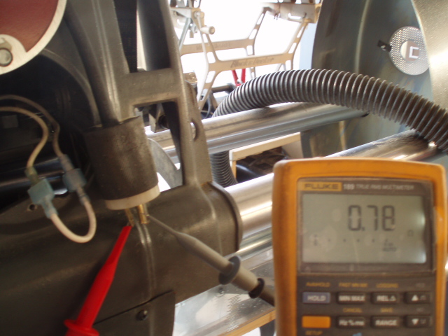

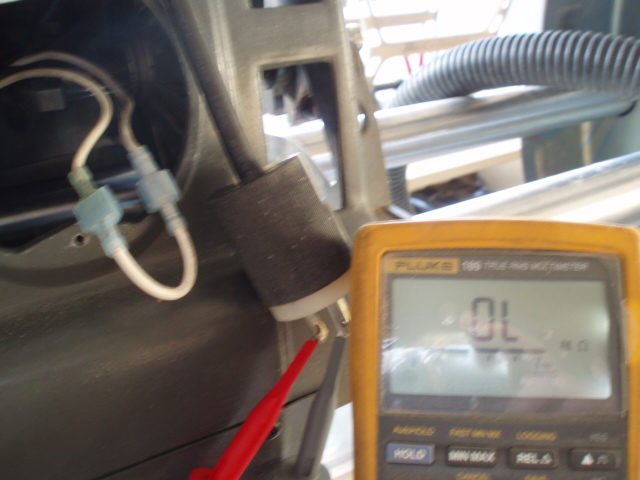

[ATTACH]10423[/ATTACH]
Switch OFF
[ATTACH]10424[/ATTACH]
Switch ON
From time to time we read here on the forum that a member has a Mark V that will not turn on or one that just hums when turned on. With that I started looking into fault isolation techniques for such problems.
I am very interested in hearing from some of you what you see when you perform resistance and voltage tests on your power cords.
Examble: The above two images show what I get when I connect an ohm meter to the Mark V power plug. One is with the switch off and the other with the switch on.
If I change the meter to measure AC Voltage, I read something I cannot fully explain and I would appreciate feedback from you all. What do you get? I measure a very low AC voltage that changes when I rotate the sanding disk.
Fault Isolation, Mark V Power
- Resistance Looking In Switch Off.JPG (133.07 KiB) Viewed 2956 times
- Resistance Looking In Switch On.JPG (147.94 KiB) Viewed 2958 times

Depending upon the meter used, the indication across the linecord(pix 1) may not indicate 'ol', but instead a very high reading(Megohms).

You are correct in saying that the "OL" indicated in one of the pictures may be an extreme high resistance reading and not an absolute open (infinity). But when I switch the power switch on, the low resistance reading is the DC resistance of the power cord (round trip), the switch and the dc resistance of the motor windings. These two contrasting readings clearily indicates that the switch works.
