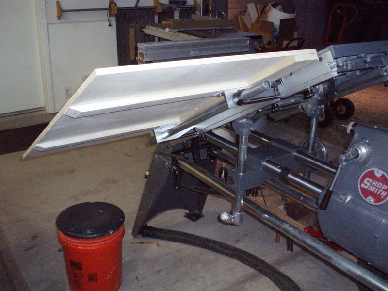

I have not yet completed the rebuild of my Height Adjustable Tilting Out Feed Table to increase its size but it is getting there. I needed outfeed table support this week so I hurried assembly.
It along with a couple floating extension tables certainly eliminates the complaint of "Table Too Small". I had a couple sheets (60" x 60") of baltic birch plywood to cut and it certainly did the job.
[ATTACH]10609[/ATTACH]
[ATTACH]10610[/ATTACH]

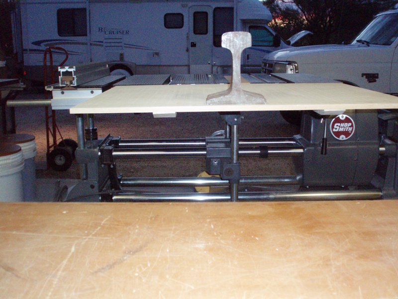

Notice the two pieces of train rail sitting on the out feed table. Together they weigh about 14 pounds; heavier than most of my cut offs. This weight has no adverse effect on overall stability.
- Desktop 025.jpg (222.4 KiB) Viewed 4542 times
- Desktop 028.jpg (208.13 KiB) Viewed 4524 times
I would not call it a semi-permanent attachment because it comes off too often; however, it is relatively easy to take off. I would guess about a minute to minute and half. My standard day-to-day configuration includes the table. That is why I worked to make it Height Adjustable and Tilting.
If you want it to be quick, use the angular adjustable leg (see previous postings). To still have the Adjustable Tilting Table but you also have the support leg to mess with.
You can see in the photos that I left the receiver for that leg on the Mark V.

Weight is a critical issue. That is why I used the baltic birch plywood rather than MDF. I could be less concerned with weight if I used the support leg but I wanted it to be cantilevered instead.

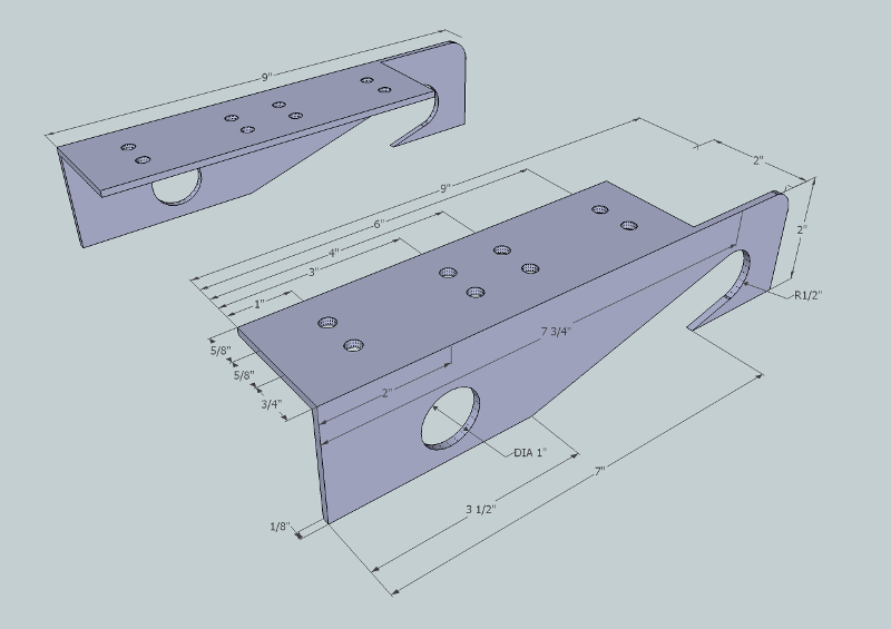

Yes, I will add a rudimentary Sketch Up drawing of the bracket.
Enlarged Table System
Here is the sketch for the Table Brackets.
[ATTACH]10614[/ATTACH]
There are some minor differences between the older 510 tables and some of the newer tables. The differences involve milling aids that were used when the tables were built. These differences will impact how these brackets actually fit. A file will be needed to "shape to fit" as required.
DO NOT REPLICATE, THERE ARE DIMENSIONAL ERRORS IN THIS SKETCH!!
- Bracket, Outfeed Table Hangers (A Pair) MODIFIED.png (100.38 KiB) Viewed 3817 times
