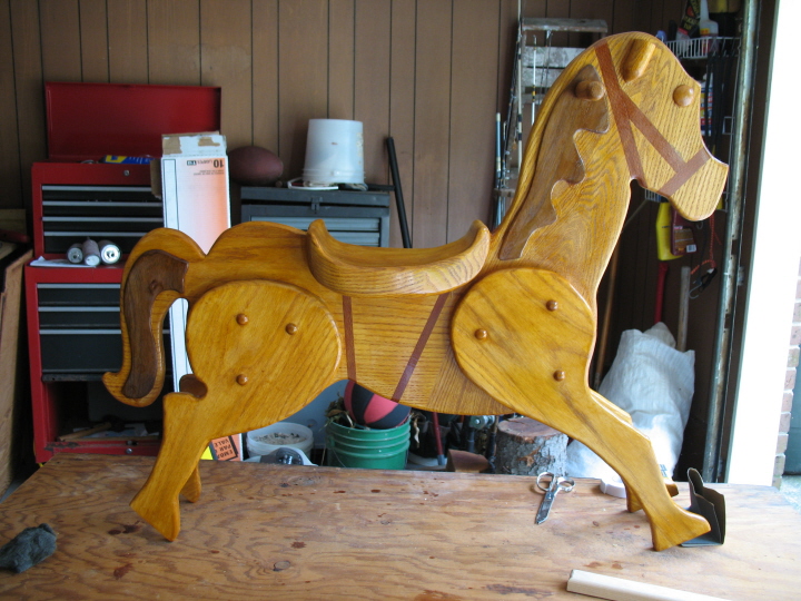

Well, I was able to finish the Rocking Horse and get it delivered on time, much to the delight of my wife and grand-daughter! I would liked to have had more time for finishing, but overall I was pleased with the project.
I'll attempt now to post pictures for the first time.
[ATTACH]369[/ATTACH]
[ATTACH]371[/ATTACH]
The body and rockers are Oak
The Mane and tail accents are Walnut
The bridle and saddle strap inlays are Lacewood
Finish is Amber Shellac

Great Job!
That is magnificent! A great job and one to be proud of! Alec
I'm not even in to rocking horses, but your photos (and Johns) now have me interested. My grand kids now being in their 20s, maybe I'll have a little one again in a couple of years. You should be very proud of your work! I know your family is.

Thanks for the nice comments, participating in this forum really helps keep my enthusiasm up!
Ron: The saddle was made by cutting mirror images on the bandsaw and then doweling them to the main body. The final shaping was done with a drum sander in a hand drill.
John: The inlays were not hard at all. I just clamped a straight edge to the body of the horse and used my router to cut the dadoes. I then cut the inlays slightly proud on the table saw and trimmed them with a sharp block plane until they fit nice and snug. Also, the inlays seem to be the feature that most impresses people when they see it, so I would definitely give it a shot on your next horse:)
Looking forward to next weeks blog!
