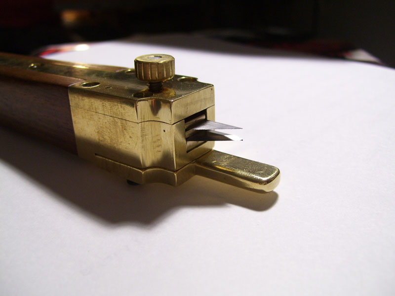

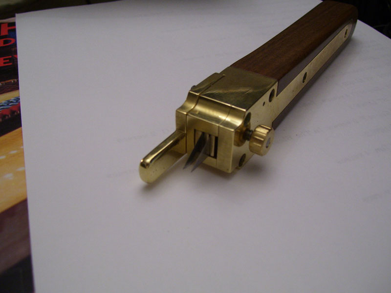

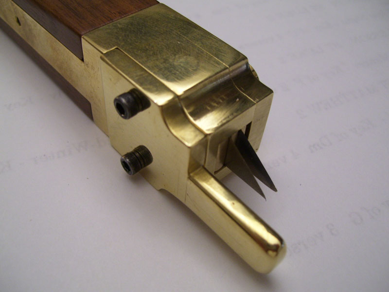

My wife's sister and her husband visited from Toronto last summer. Dave retired from the Toronto Transit Commission as a locksmith, and set up his machine shop at home. I believe the floor pad cracked under the lathe and he had to dig a new pad foundation! Anyway, while he was here, we talked tools, and I described a cutter that could be used to cut a channel for purfling; that's the strip that goes near the edge of a violin or guitar. Most guitars have edge binding, and a single knife would do, but for a violin, you want to have a nice channel to inlay into.
Dave went home, and made the tool you see in the attached pictures. The tool cuts the channel, I would still need to uise a small chisel to clean out the trough.

End Detail

Another detail of the business end
[ATTACH]11109[/ATTACH]
And again, the business end

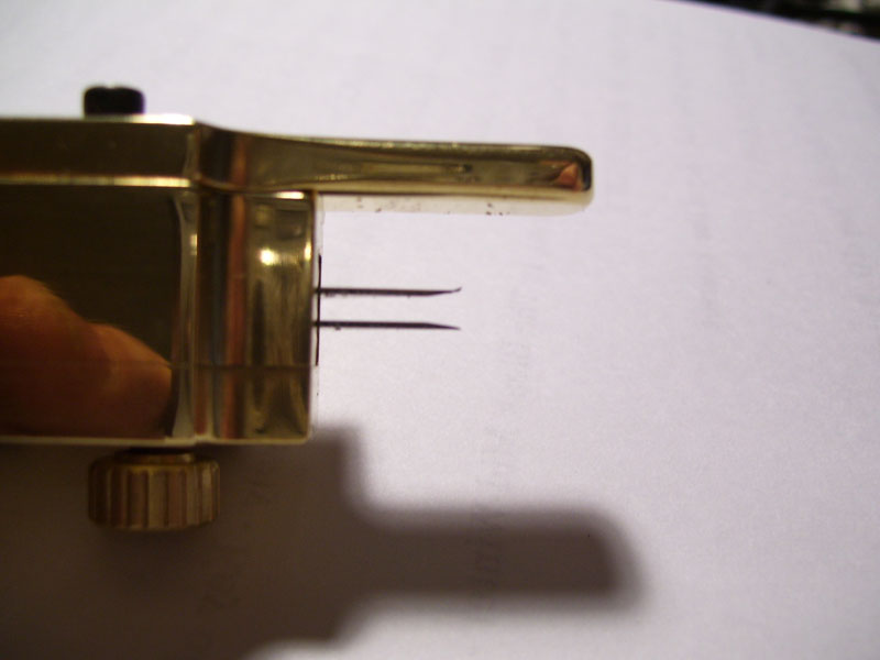

Side View
[ATTACH]11111[/ATTACH]
Detail of the knives
The knives are reversible, and there are spacers to set the distance from the edge guide, and the distance between the knives. The knives are X-Acto #24 blades, which are 'sharp one side' so the sides of the channel are straight. You (ok... I) could also use one knife to cut a rebate edge (rabet). The edge guide is also reversible, so you can cut one side or t'other and always cut on the pull. I have asked him to make another edge guide with a thinner shank to get into tight corners.
The bulk of the tool is brass, and the wood is walnut. I can't say enough about the skill and, well, the love that went into this tool. I have used it on some test pieces, and it cuts a nice channel with square sides.

What I particularly like is that this tool has some heft to it. It is about 8" long, and 1 1/4" square at the business end. I used it a bit today on another test piece. It seems it works best to take a shallow cut, then clean out the groove, then another shallow cut, and so on. I'm not on piece-work, and if I don't actually finish a piece, the experience has already made my life better.
