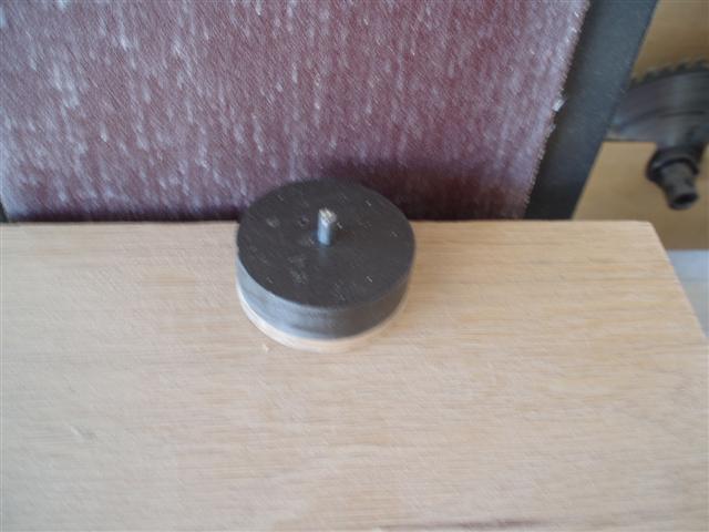

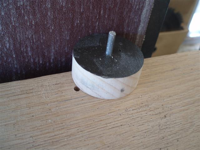

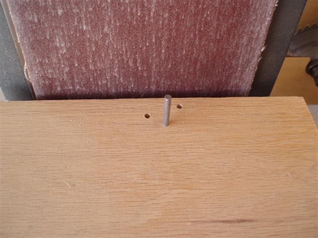

I put a runner on a piece of wood a little larger than the belt sander table. The edge of the block can then be adjusted right up against the sanding surface.
I then attached the wheel to the table (originally using a nail) which I later changed to a short piece of steel rod (diameter of the axle.
Mount the wheel, adjust the table til the wheel just touched the sanding surface, lock it in place and rotate.
This can actually be done without cutting out the wheels. The belt sanding does all the work while you spin the block til it is a wheel.
[ATTACH]11161[/ATTACH]
[ATTACH]11162[/ATTACH]
[ATTACH]11163[/ATTACH]
