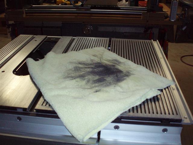

Wondering where the black on your fresh cut pieces comes from?
[ATTACH]11167[/ATTACH]
- PC080003 (Small).JPG (50.94 KiB) Viewed 3066 times
Yep, an inherent problem with aluminum tables.
I've been ripping a lot of white ash on my 510 recently for my raised panel pantry project; and have been blowing off the table at the end of the day, wiping on a new coat of Johnson's (using Nick's tip to use a grey Scotch Brite pad), waiting a few minutes, then buffing with a rag.
I think we see the black marks after the wax coating is worn away. Aluminum oxidizes rapidly when exposed to air.
BTW, Dusty..... That's a pretty clean rag compared to what I get off mine sometimes....

I've been ripping a lot of white ash on my 510 recently for my raised panel pantry project]That's pretty nasty when you consider the fact that I pride myself in equipment maintenance AND the fact that the other side of the rag looks the same way.
