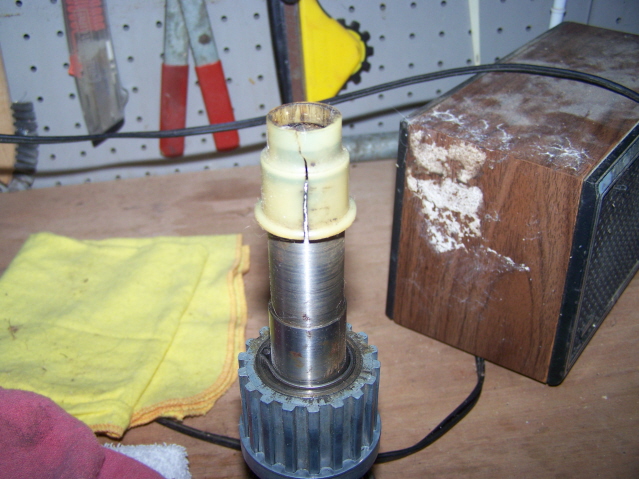

On my greenie the only purpose that plastic piece serves is as a dust cover to keep dirt and grime from geting into the female part of the drive shaft. My is cracked and it works fine (see attached).

Thanks for all your replies. No the quill wasn't overextended. The set screw was in place. I think maybe the plastic just degraded. The machine is about 30 years old. I have removed the quill assembly, which was easy, and have removed the two broken halves of the coupler and it's definitely a coupler-- apparently secured to the upper drive with a friction ring. That plastic part is apparently all that connects the spindle from the quill assembly with the upper drive shaft.
