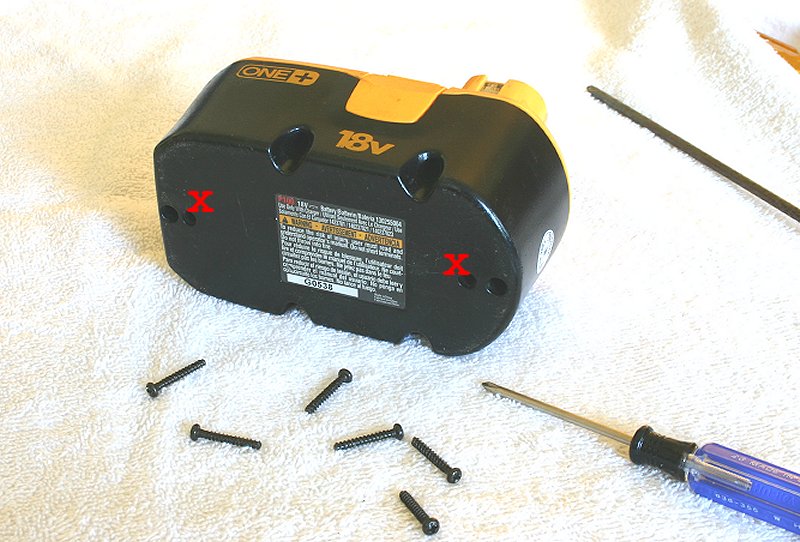

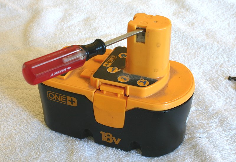

Opened up the case. Six screws. "RED X" = not a screw hole.
[ATTACH]11279[/ATTACH]

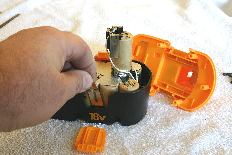

Press down on the terminal while pulling up on the cover to remove it.
[ATTACH]11280[/ATTACH]
Remove locking clips
[ATTACH]11281[/ATTACH]

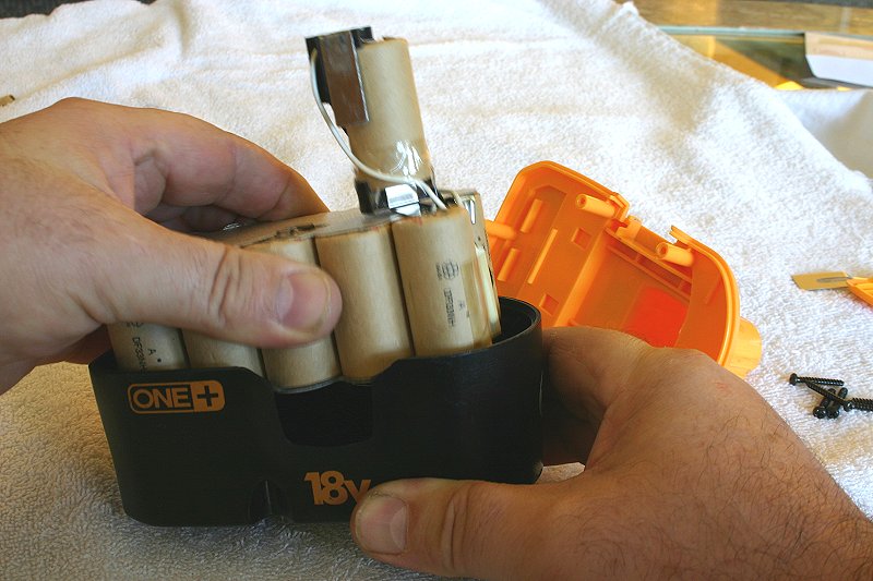

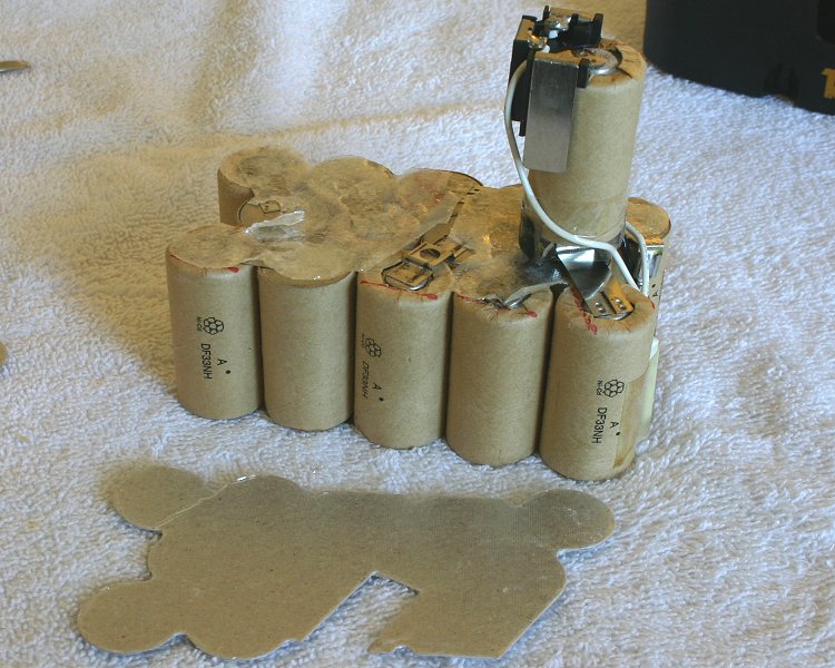

Pull battery pack out of housing. This exposes the fifteen individual 1.2v cells.
[ATTACH]11284[/ATTACH]
Remove insulating cardboard layers on top and bottom to expose + / - battery terminals. Note: There is a double sided adhesive tape on the surface of the batteries that can be left on.
[ATTACH]11283[/ATTACH]

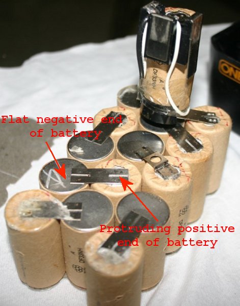

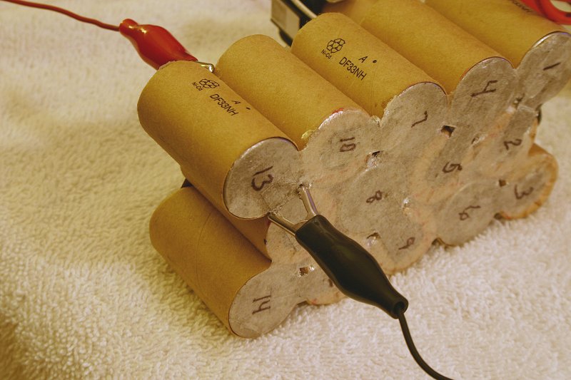

Looking at the individual cells, flat end is negative, protruding end is positive.
[ATTACH]11288[/ATTACH]

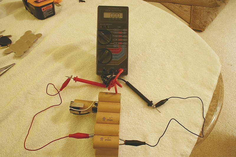

Number each of the cells so that you can keep track of which ones you've done then connect an alligator clip lead to the metal conductor that connects the battery to it's neighbor. Black will go to the flat end of the battery, red to the opposite protruding end.
[ATTACH]11286[/ATTACH]
Set up the meter so that you can monitor your progress.
[ATTACH]11285[/ATTACH]

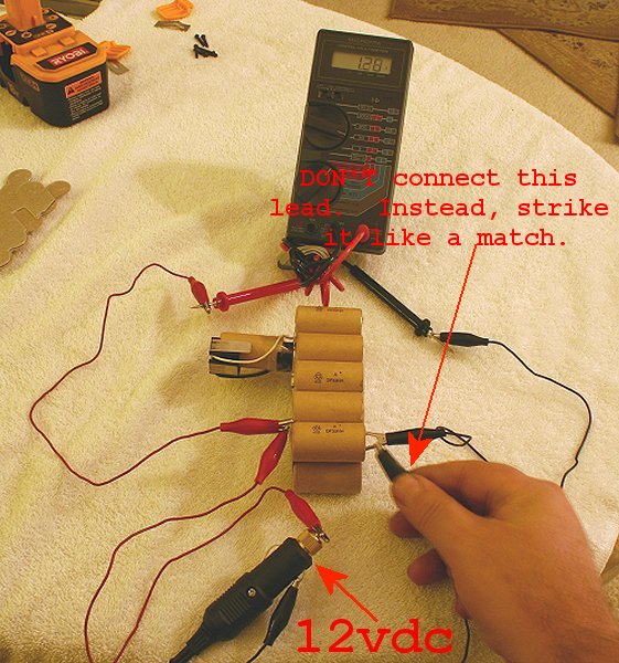

Hook up another set of leads to a 12v power supply (connect to you car battery with it still in your car if you want) red to positive, black to negative, and clip the positive lead to the one on the battery pack. DON'T HOOK UP THE BLACK LEAD FROM THE POWER SUPPLY TO THE BATTERY PACK. Instead, hold it in your hand and just touch it up against the black lead alligator clip connected to the battery pack as if striking a match and break contact immediately while observing the volt meter. When the lead contacts, it will create a spark and you'll notice the voltage will rise instanteneously then immediately start to drop off once contact is broken. I would strike it again and release when I saw the voltage reach ~1.4v. Again, the voltage drops as soon as you break contact.
[ATTACH]11289[/ATTACH]
Repeat this same procedure for each of the remaining 14 cells making sure to connect the black lead to the flat (-) end of the cell and red to the protruding (+) end of the cell.
After this, I reassembled the pack and slapped it on the charger. It took a total of 3 hours for the green light on the charger to come on. Normally, with a new battery, it takes only an hour. I installed the battery pack in the drill and tried it out. Good news is that I could NOT stop the chuck from spinning with the hand like I could previously. It definitely had the torque of a new battery. Tomorrow, I'll run it through the paces and see how long it lasts while closely monitoring it's voltage.
