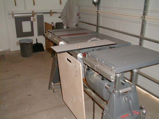

If you do very little work on your table saw that would produce pieces that end on the outfeed table, then setup may be more trouble than it is worth.
However, I can install my outfeed table in the time it takes you to fetch that ladder. Furthermore, it is set up and ready to use in about the same time it takes to fold out the ladder and put it in place..
When I am all done setup, the table is at the height of the main table and adjusts with it as you change depth of cut.
[ATTACH]11364[/ATTACH]
This is the old table and the pictures were taken before it was completed (no miter slots and no t-track).
To each his own but I can not imagine being without an outfeed table.
