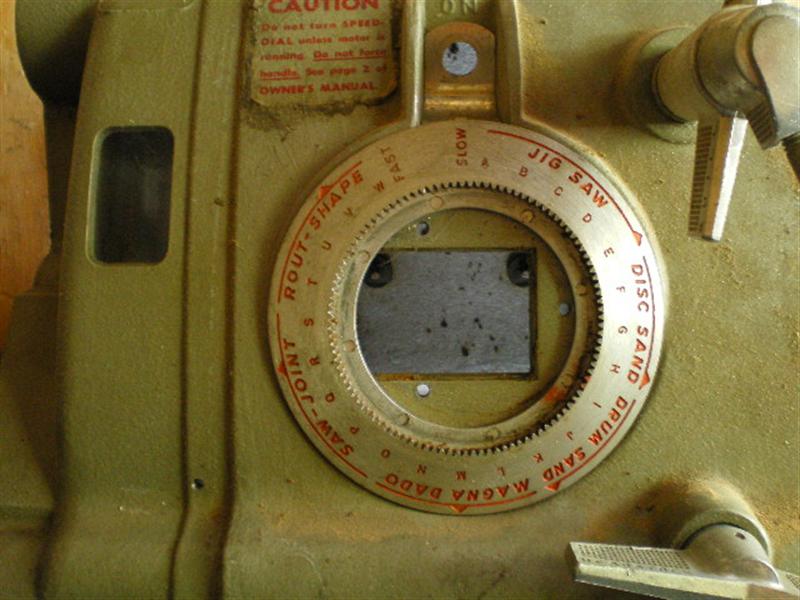

Motor runs fine and speed control works. I would say that you are almost in the business of making sawdust. I suspect that you have the quill locked and that is why you can not move it in/out with the handle.
The speed at which you run for drilling is somewhat dependent on what you are drilling but whatever it should be slow. I would suggest you start at B or C.
The quill lock should be labeled on the handle but, if not, it is shown in the attacked image in the upper right hand corner. The lock directly opposite the quill lock (other side of headstock) is the depth lock.
Speed Control Spring5 (Medium).jpg (72.19 KiB) Viewed 1562 times
To add just a little bit (no pun) - After you loosen the quill lock, also loosen the depth lock. Then extend the chucked up drill bit to the piece you want to drill - set the the depth control (numbers 1 to 4+ in inches) to the depth you wish to drill and lock it at that position. You should now be ready to go.
