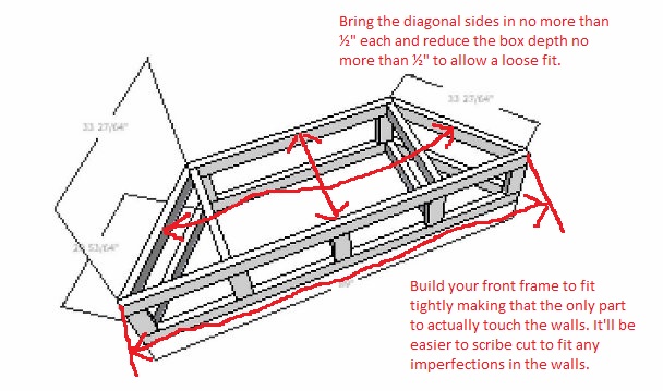

:cool: So could I now ask for comments and opinions on the frame design below? :
kennygolub wrote::cool: So could I now ask for comments and opinions on the frame design below? :
The front and rear appear to be well supported by the vertical members. How about the sides??? I would add a vertical member at each end of the sides.
I assume you intend to line it.
I would also hinge a lid on the sides with the hinge on the 'outside' edge.
I am inclined to agree with mark re the center being drawer access rather than a lid. 2 each his own!:)
P.S. N "8" Where's zat?

Post by dasgud »
I hope this is a good suggestion for you. I'm sorry I didn't take the time to draw a new one in sketchup. I know my image editing is really rough :(.
[ATTACH]11439[/ATTACH]
If you build the front face frame to fit tight or even slightly long and the cabinet frame to slip in with space on three sides then you will avoid issues of walls that aren't plumb or angles that are not exact. If shimming the cabinet box isn't good enough solution, you can glue a lip on the outside of all the top rails then scribe cut to fit any contours.
That's what I would do, make the face frame fit tight (build all corners at 90° and scribe cut to fit if necessary) and the cabinet box loose.
I like the idea of making drawers, but if you love the idea of a hinged top lid then charlese has covered the solution for that.
One last suggestion :) don't forget to take pics so we can watch the progress :).
