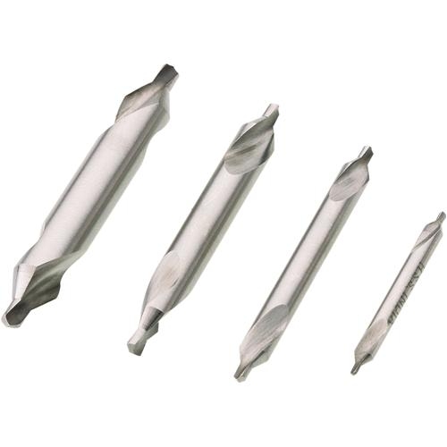

One way is to find someone with a metal lathe and have them use a "center drill" to drill the end of your pin chuck so that it will mate with a live center. Here's the type of bit that's used and one can be obtained from places like Grizzly, MSC, Enco, etc:
[ATTACH]11515[/ATTACH]
You may get satisfactory results on your Shopsmith by clamping something like a piece of 2x4 on edge to the table in drill press mode and then drilling a hole into it with a 5/8" bit about 3 1/4" deep. Then while the 2x4 is still clamped in place, insert the pin chuck into the hole and drill the end with a center drill just deep enough to create a seat for the live center. If you don't change any of your setup except putting your chuck in the hole and swapping bits, you should be successful in drilling the center of the chuck. You may need a length of 4x4 between the floor and the bottom of the drill press table to add stability to the setup. You also could try a dry run by drilling the headstock end of the pin chuck to see if this will work for you on the Shopsmith.
Perhaps you also could think about shortening the length of the pin chuck to something that is just a bit longer than the blanks you're using plus enough extra for clamping into the collet chuck.
