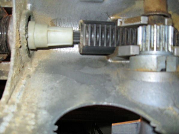

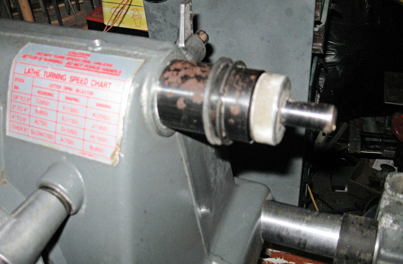

A couple days ago, I bought a 510, which the seller said "was kept under a tarp outdoors for the last 13 years". It was missing a few necessary items (miter gauge, drill chuck, lathe drive arbor) but I got it for $140. I have dropped the motor and turned it on, ran very smoothly. The motor pulley will need disassembly I think, since it is stuck. I expected the unit to be much more rusty than it is. The way tubes have a little light rust and should shine up nicely. The base tubes are quite rusted and will require turning and lots of sanding. I checked out a local source (Princess Auto) for Evaporust, which I read on this forum will save a lot of work, but they did not have it. They do carry a product similar to Naval Jelly.
[ATTACH]11555[/ATTACH]
This quill is stuck. The head is pretty clean inside.
[ATTACH]11557[/ATTACH]
I suspect corrosion freezing the quill to the aluminum head.

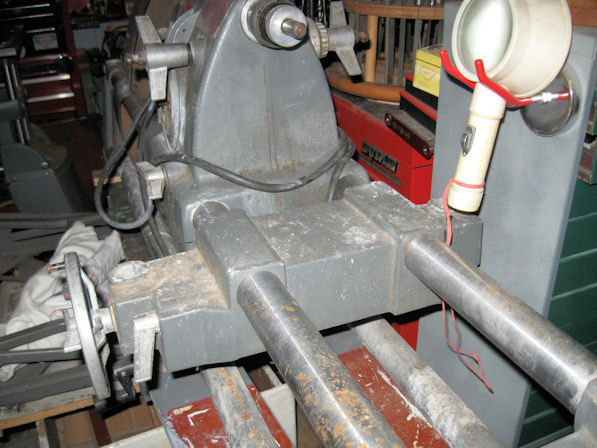

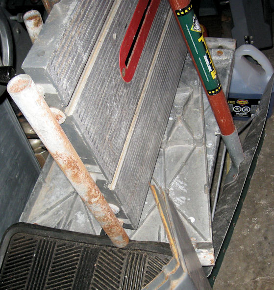

The pipes on the tables look like this :
[ATTACH]11556[/ATTACH]
1. Any thoughts on how to free the quill? I took out the setscrew and am squirting in penetrating oil.
2. What is the best way to shine up the table pipes?
Thanks for any advice.

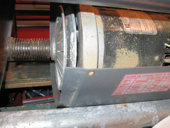

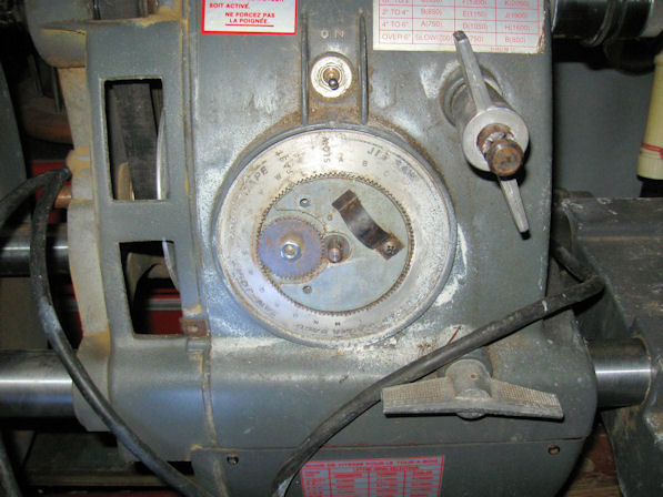

Here are a few more photos:
[ATTACH]11558[/ATTACH]
[ATTACH]11559[/ATTACH]
[ATTACH]11560[/ATTACH]
The speed dial is in good condition, as is the porkchop. The idler shaft came out easily and the pulley cleaned up and now slides smoothly on the shaft.

- motor.jpg (76.35 KiB) Viewed 3993 times
- rusty pipes and head.jpg (80.65 KiB) Viewed 3993 times
- speed dial.jpg (76.09 KiB) Viewed 3999 times

Navel jelly is acid, and attacks the 'good' iron as well as the rust. If you can rig up a long skinny electrolysis container(plastic sheet in a crate), it is quite inexpensive, and does not attack the 'good stuff'.(see mickyd's setup) The less abrasives the better(use them to polish, not 'remove' rust).
I would remove the quill feed shaft prior to attacking the 'stuck' quill. That would allow more aggressive(further motion) rotation.

Thanks for the advice jpg. No naval jelly! Good thought about removing the quill feed shaft, will do so. What is the best way to apply some force to the quill?....I'm reluctant to wack it with a big hammer! I will try to rotate it with a strap wrench. By the way, the shaft spins freely so the bearings seem fine.
Judging from the lack of much wear (there is some) on the porkchop and idler pulley, I think this machine has not been used much.
Good catch on the label......... SS's sold in Canada came with all labels in both English and French, at least the ones I have seen..
I have never used electrolysis but I do have a car battery so that would be interesting to try. I will search the forum, lots of info on "how" there.
The serial number is 110888 which means built in Aug 1988?

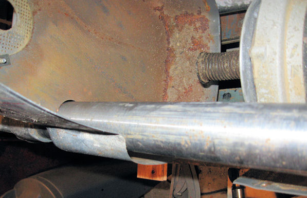

The rust in the end cover would tend to confirm the seller's 13 yrs. story.
[ATTACH]11567[/ATTACH]

- end cover.jpg (64.45 KiB) Viewed 3966 times

Maybe these folks can help you find a local carrier of Evaporust.

I HIGHLY recommend it. I soaked my way tubes in a 50/50 solution of Evaporust and water in a 3" x 5' PVC pipe with a cap on one end with great success. I absolutely hate Naval Jelly and wouldn't use it for anything more than quick surface rust removal. I don't think it works nearly as well in cold temps either.
For loosening the quill, I applied Liquid Wrench penetrating oil to my SS every day for about a week. If you have PB Blaster available, that's great stuff. After that, the quill feed was able to extend the quill. FYI, once its' moving, placing a 2x2 behind it to force out the drive shaft is pretty handy. Be sure to apply plenty of penetrating oil here too.
Mickyd used a fine brass brush to remove tarnish on his tables. Here's his link on reconditioning the tubes and the rest of his restoration.
Sawdust Session on Cleaning and Inspection

EDIT: update...I got the quill out using Channel-locs. It was stuck in by some corrosion and some raised areas on the slot caused by someone screwing down the setscrew when it was not lined up with the slot.

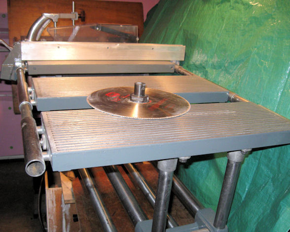

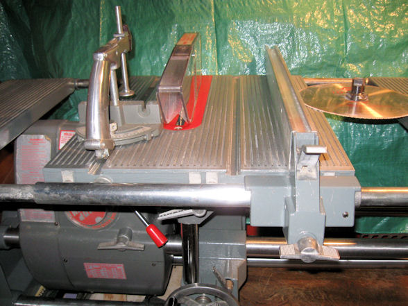

Update: Refurb went well and the 510 looks and runs pretty good now. I ended up painting the base ends, legs, table edges and carriage because of large areas where the aluminum had corroded under the original paint. More evidence that it really did live outdoors under a tarp.
Unfortunately, had to use a lighter grey enamel (what I had already), could not find a better match locally and did not want to take the time to do better. In a hurry to get on with it, I ended up turning the base pipes in my metal lathe, using succesively finer emery paper. Took about 1/2 hr to shine them up adequately. There are still some areas of darker discolouration. Here are a couple of pictures.
[ATTACH]11955[/ATTACH]
[ATTACH]11956[/ATTACH]

- saw table.jpg (82.37 KiB) Viewed 3837 times
- tables.jpg (79.94 KiB) Viewed 3833 times
