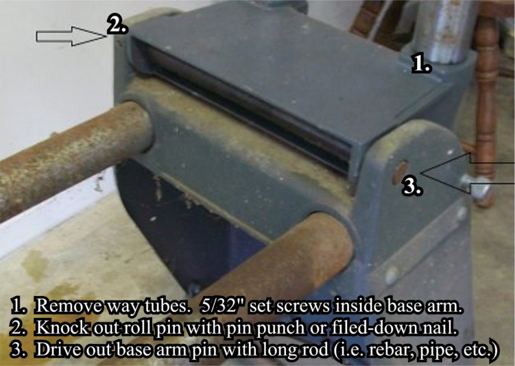

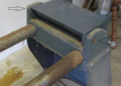

I'm new to this so I have no idea on how to remove this Base Arm Pin or Retaining Ring. HELP PLEASE!
I attached a photo. Not really sure how to make it post on my thread.

I went through the same thing. :)
1. Remove way tubes. 5/32" set screws inside base arm.
2. Knock out roll pin with pin punch or filed-down nail.
3. Drive out base arm pin with long rod (i.e. rebar, pipe, etc.).
BE SURE TO USE PLENTY OF PENETRATING OIL.
[ATTACH]11583[/ATTACH]
Here's how to insert photos. Best of luck!
Base Arm Removal.jpg (96.33 KiB) Viewed 4327 times

You need to first drive the roll pin out of the base arm pin. There is an access hole in the base through which you do this. Then you should be able to remove the base arm pin.

One other thing: just let the roll pin fall into the base arm when you punch it through. It will fall out the bottom of the base arm.
Dalton
Fort Worth, Texas
1962 MK 5 #373733 Goldie
Using the proper size pin-punch is important. If you manage to flare that roll pin while trying to drive it out can be a task terminator. I also recommend using a new pin when you get ready to reassemble.
