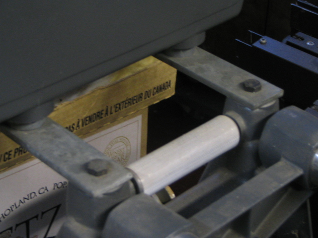

camerio wrote:Here is how I dealt with that.
A picture is worth ....
this is screwed in dowel of wood big enough to fit in there
and the plates of metal are about a quarter inch thick
Sorta like these! 1/2" thick steel works better(less whippy).

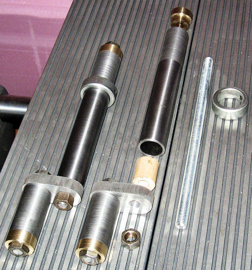

Here is a pair of eccentric tubes I made using a South Bend metal lathe and a belt sander. Nice to have tools!
[ATTACH]11794[/ATTACH]
- jigsaw eccentric tube components.jpg (97.56 KiB) Viewed 3427 times
Peter

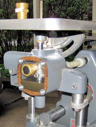

I made them to mount a jigsaw that I bought which was without any tubes, seen here:
[ATTACH]11795[/ATTACH]
Probably straight tubes would have worked but I don't recall why I decided to make them eccentric.
Anyway, they work!
Anyway, they work!
- overview.JPG (72.15 KiB) Viewed 3359 times
Peter
