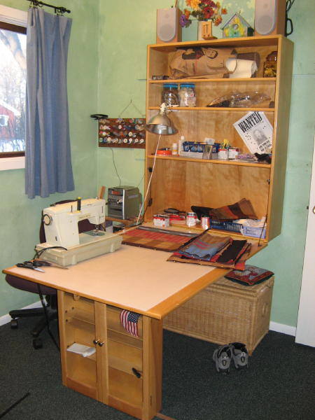

Here are a couple of snap shots of a sewing center I made years ago. If you’re interested I’ll search for the plans. The OA dimensions are 36 wide, 48 high, and 11.5 deep.
She picked this unusual design because the room serves as a guest bedroom in addition to being her sewing center. This design doesn’t take up any floor space. I used French cleats to hang it.
You can see it's a wall cabinet that folds open for use. The glass doored portion becomes the outrigger or leg when open. When I built it I thought she'd use that small cabinet for sewing supplies but because it's so difficult to access when in use it doesn't get used in that way. Before someone comes to visit she usually puts in a few display items. The shelves are adjustable in both the main cabinet and the display unit.

Wow neat and very inventive design. Our new sewing room has a great deal o floor space and the request is for a free standing cabinet. Than you just the same I truly appreciate the offer. Jimberry wrote:Here are a couple of snap shots of a sewing center I made years ago. If you’re interested I’ll search for the plans. The OA dimensions are 36 wide, 48 high, and 11.5 deep.

Send me the plans please - Looks like a great idea & I have very limited space & lots of sewing to be done. Thanks. PM me if you need address.
