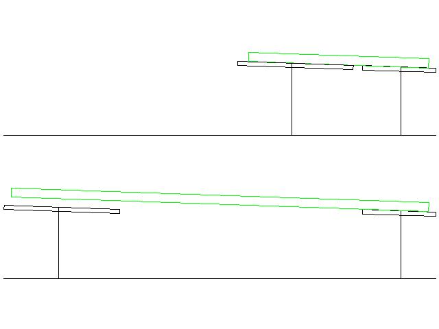

Thanks Dusty. That's what Rob suggested also. I'll check that. I'm trying to visualize the effect that would have. It seems to me that if there was a twist, I would see a difference in the gap front to back. In an extreme case, one table would appear to be too high in the front and too low in the back. I do see a slight difference in the gap, front to back, so there is indeed a bit of a twist. But what I also see is a gap left to right, that's consistent (mostly) front to back. I've attached an exaggerated drawing to help illustrate. Would a twist have this effect?

- tilted.jpg (15.7 KiB) Viewed 1380 times

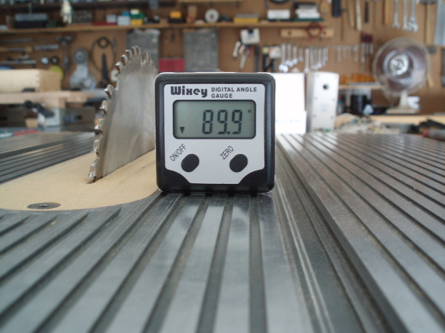

The use of the Wixey digital angle gauge has save me many many hours of setup and alignment time in the past 5 years. This is one of the best tools I have purchased and recommend all Shopsmith owners have one. I use it often and am still finding new usages for the Wixey. It provides a real quick way to check previous alignments.

NO, Denver. If I am reading your sketches correctly, it appears that the main table is not square to a plum line dropped off of either the front (infeed) or rear (outfeed) edge of the table. Followed by an extension table whose top surface has be adjusted to be in the same plane as the main table.

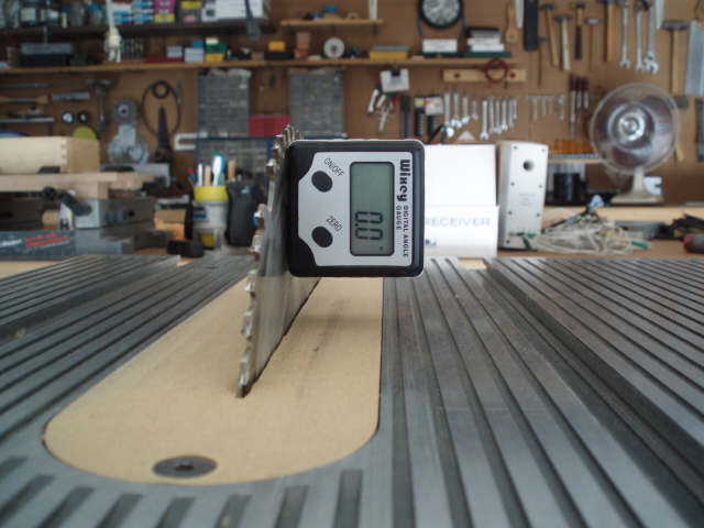

Is the blade square to the main table top?

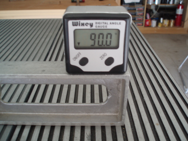

These can be done with a glass of water and a weighted string and a ruler OR with a bubble level and a square OR with a Wixey like Bill has suggested. One is more time consuming than the other but reasonable accuracy is achievable with any of the three. Check with the architects and builders of the pyramids if you are in doubt.

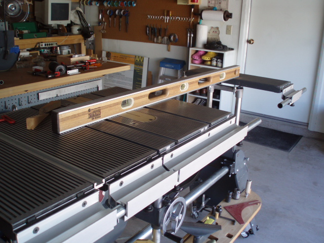

[ATTACH]11801[/ATTACH]
All tables are in the same plane as indicated by a 5' level.

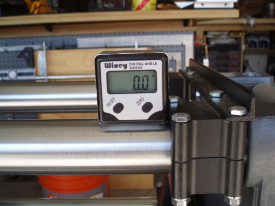

With a Wixey, you would like to be able to move it to all locations on the Bench and Way Tubes and get this same relative reading.
[ATTACH]11802[/ATTACH]
Wixey Zeroed Here and then moved along all the tubes checking for relative position. If the same reading was achieved everywhere the tubes would be perfect. I hope for everything to remain within +- .3 degrees.
- All Tables in Same Plane.JPG (154.42 KiB) Viewed 1585 times

More of thew same:
[ATTACH]11806[/ATTACH]
[ATTACH]11807[/ATTACH]
[ATTACH]11808[/ATTACH]
- Starting Point (Wixey Zero).JPG (150.67 KiB) Viewed 1585 times
- Main Table Good.JPG (144.13 KiB) Viewed 1587 times
- Extension Table Good.JPG (147.43 KiB) Viewed 1585 times
