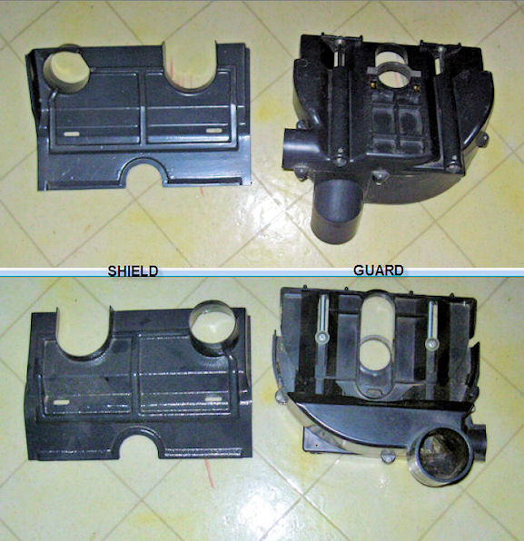

I received these two pieces ( a dust shield and dust pickup or guard) with a Shopsmith 500 and a 510 but do not recognize them. I suspect they go together and mount on the 500 unit. The photos show both sides of them. Can someone confirm what they are and which model they fit. Thanks in advance!

They are both part of the model 500 lower saw guard upgrade. John McCrossen
http://www.shopsmith.com/ownersite/part ... ew_500.htm
Tie bar shield (item # 155)
http://www.shopsmith.com/ownersite/cata ... pgrade.htm
Lower saw guard
Lower saw guard
