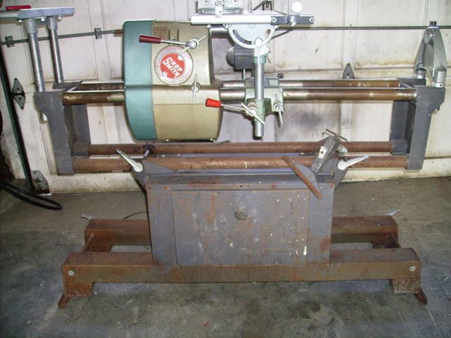

I have the Frankensmith to become my dedicated lathe and since it is based on a Mark VII it is a lot heavier than a Mark V and would also be easier to add weight to it. The weight can be added down low on it for added stability. I don't use what I call the kangaroo pouch (the dust collection box in the base) so I could add a lot of weight to it. The feet of the Mark VII base also provide large flat areas down low where weight could be easily added. I have no intention of ever tipping the Frankensmith to vertical and may even bolt the whole tube assembly rigidly to the base including some added struts out at each end connecting the tube "cage" down to the ends of the feet just to add stiffness to the whole thing.
Here is a picture of the Frankensmith when I first started working on it. It is still ugly but it is on a whole different base now with a completely different type of caster set. I put the picture here to show those not familiar what kind of configuration a Mark VII frame has. I suspect that filling the kangaroo pouch full of bricks will be plenty of weight.
[ATTACH]11929[/ATTACH]
SS Frankinsmith small pic.JPG (73.82 KiB) Viewed 912 times
