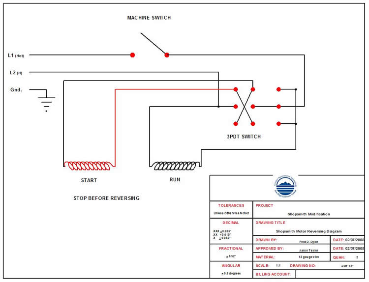

btw, Is this diagram reasonably accurate?

Yes, switching the wires to each end of the start windings is what changes the rotation. I connect the start winding wires to the center position of a DPDT toggle switch and add an addition wire to each of the power input wires to one end of the DPDT switch and reverse the wires to the other end of the DPDT switch. This is a diagram that someone posted on one of the Forums.damagi wrote:
[ATTACH]11996[/ATTACH]
- Shopsmith Motor Reverse Diagram.jpg (33.68 KiB) Viewed 7356 times

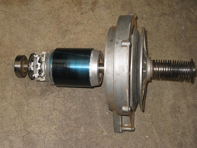

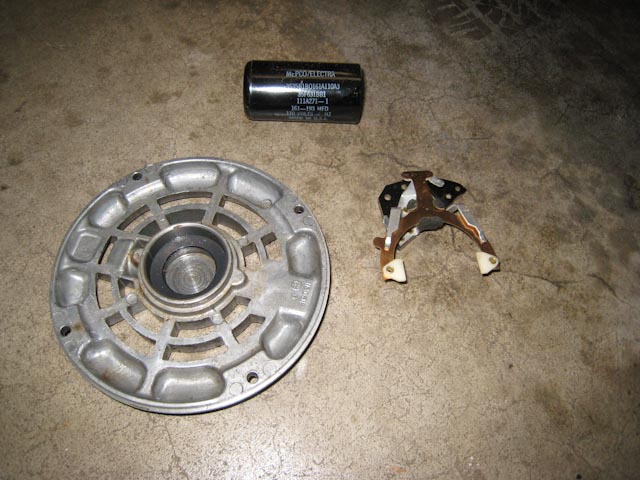

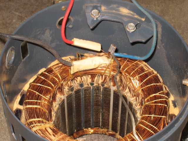

Some shots of the motor. The bare wire was previously white. The insulation was cracked, so I removed all of it.

[ATTACH]11999[/ATTACH]
[ATTACH]12000[/ATTACH]
[ATTACH]12001[/ATTACH]
- Motor (1).jpg (97.03 KiB) Viewed 7027 times
- Motor (2).jpg (115.49 KiB) Viewed 7057 times
- Motor (3).jpg (92.78 KiB) Viewed 7027 times
