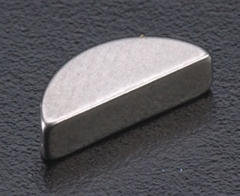

A woodruff key fits into a dished out keyway in the shaft. A pulley that connects to it has a flat keyway cut into it.
[ATTACH]11965[/ATTACH]
A woodruff key is essentially a truncated cylinder.

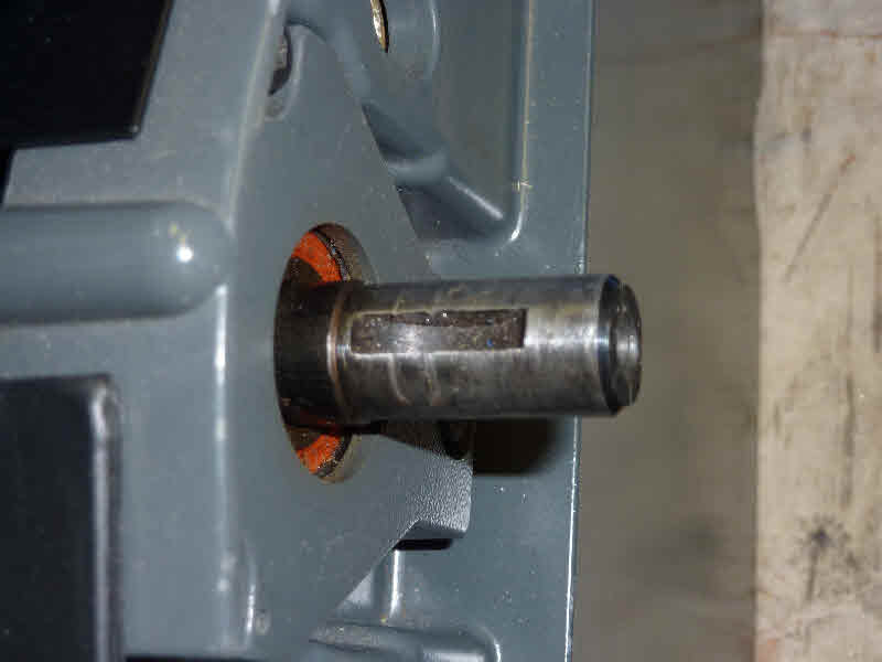

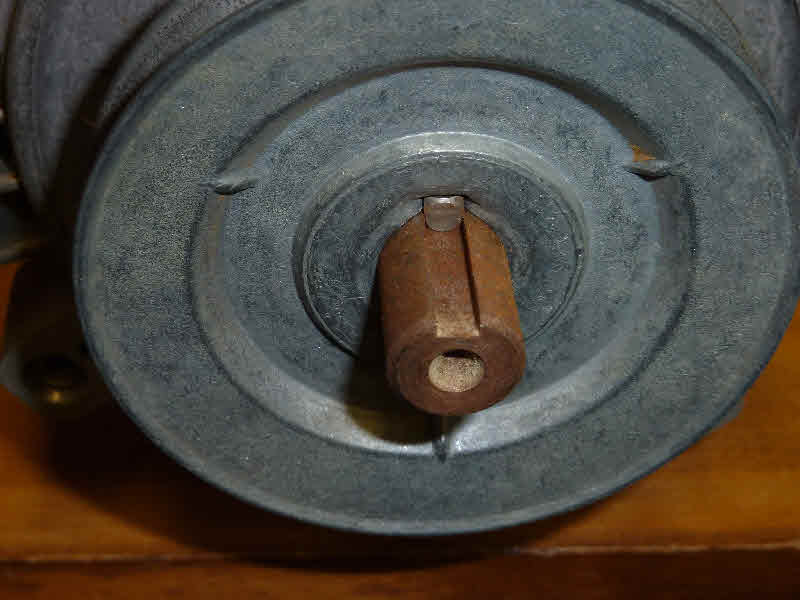

There are, in fact, both types of keys used on the planers. The one I recently picked up was milled for a straight key (which was missing). It was built in March of '83. My previous planer, which I am mounting on the power stand, was built in August '96 and has the Woodruff style keyway. The first picture is of the motor shaft with a straight key/keyway. I already sold the other planer (1983) so can't get a picture of it but it is the same. The second picture is of my original (1996) planer drive shaft with the Woodruff keyway. It is, as JPG described, dished out to fit the radius of the key..... actually, the other way around- the key fits the keyway, or keyseat as it is sometimes called.
The important part is that the key is there as the set screw is not sufficient to lock the pulley on the shaft. This was clearly evident on the '83 planer as there were small grooves on the circumference of the shaft created by the set screw when the pulley rotated on the shaft after the set screw loosened a bit.

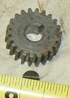

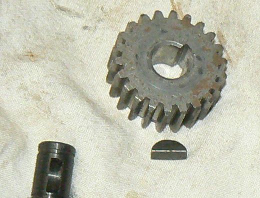

Key is 'full round' 1/8" thick, 3/8" wide and .171" tall.
http://www.mcmaster.com/#woodruff-keys/=b3orlk
[ATTACH]11974[/ATTACH]
[ATTACH]11975[/ATTACH]
Mine is a 'manual' feed, but the parts are the same as motor feed(gear,key).
