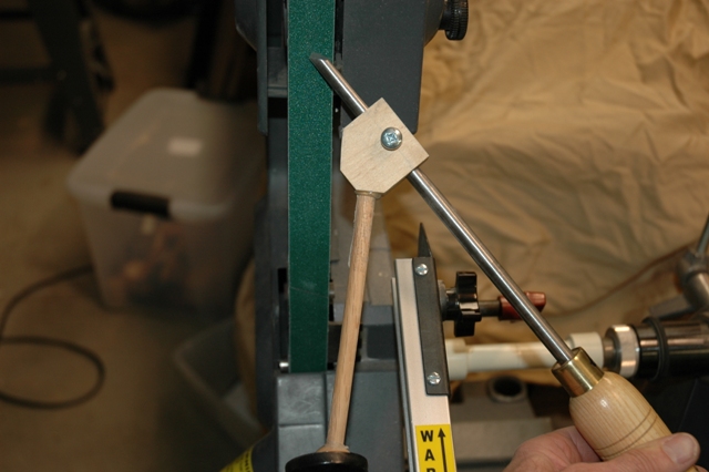

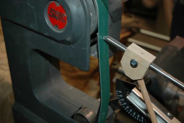

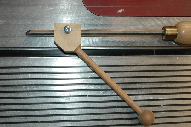

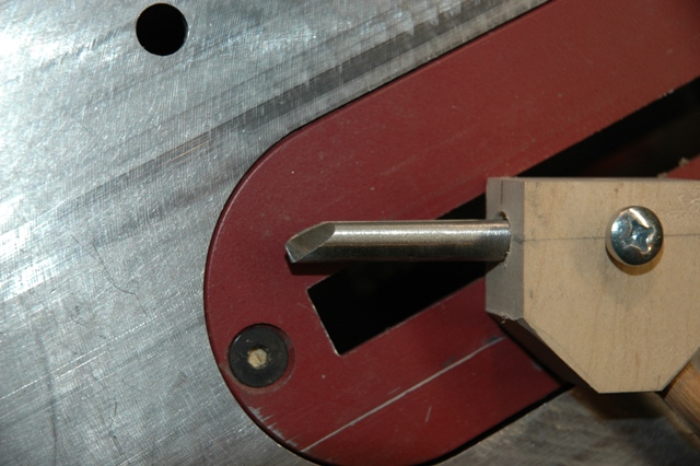

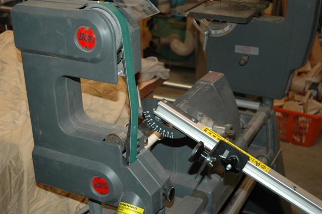

Here is my solution for putting a fingernail grind on my new bowl gouge using the Shopsmith strip sander. I made it out of scrap and stuff I had on hand. I made the jig using a 1-3/4" square chunk of 7/8" maple for the jig head, a 6-1/2" piece of 3/8" dowel and a 1" wooden ball. I drilled a 13/32" hole through the jig head that made a nice fit for the 3/8" gouge. I drilled and inserted the dowel into the maple jig head at a 45 degree angle and then mounted the ball on the other end of the dowel (Thanks to Ashbury for that idea). I drilled and tapped a hole for a set screw that tightens from the side of the gouge. To sharpen the gouge, I inserted it into the jig and tightened the set screw leaving 2" of the gouge extending beyond the face of the jig. For the initial grind I used an 80 grit ceramic belt on the strip sander. I adjusted the angle of the sharpening attachment and the location of the cup until I obtained the grind angle I wanted. It fell at 65 degrees on the attachment indicator. The gouge had to be sharpened at the top of the strip sander platen in order to clear the sharpening attachment when swinging to the right. I placed the ball end of the jig into the cup of the sharpening attachment, turned on the strip sander and rolled the tip of the chisel from side to side against the belt. After shaping the gouge to the new fingernail grind with the course grit belt, I progressed up through finer grit belts to get a very sharp cutting edge. (The photos are after a 120 grit belt.) I can now duplicate a very nice edge on my new bowl gouge and get smooth cuts on end grain without the catches I was getting using the spindle gouge. If I get other sizes of bowl gouges I will make a jig for each. I hope I was clear enough in my description and that it will be helpful to other members of this forum.
