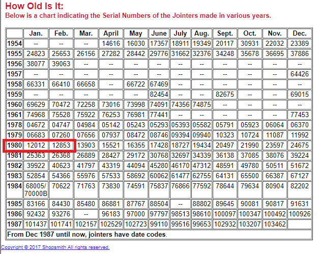

The '54 Greenie I have came with a matching green jointer with a 12xxx serial number. Does anyone by any chance have the numbers for Jan-March of '54 from Magna? It'd be cool to possibly put a month on the assembly date of this machine.
And yes Dusty, Arizona has been awesome on this markV, but I don't suspect it was ever in a shop with swampcoolers. My metalworking lathes and mills at work are a pita to keep rust free during the summer. haha
Marc
Phoenix, Az.
Mark V "Greenie" SN 264779 with Magna Eng jointer SN 14512
everettdavis
Posts: 2163
Location: Lubbock, TX
Re: Jointer serial numbers
Post by everettdavis »
WorkinClass wrote:The '54 Greenie I have came with a matching green jointer with a 12xxx serial number. Does anyone by any chance have the numbers for Jan-March of '54 from Magna? It'd be cool to possibly put a month on the assembly date of this machine.
That depends on the XXX portion.... Which month is yours depends if it was earlier than the last serial number made in the month which is what they list. You can extrapolate the month from those last 3 numbers.
If it's after 12853, then March it is.
Since they were averaging 800 - 1000 units a month, you can estimate the week number based on where your number falls. Not exact, but close.
It came from the link supplied above
This info is all that is available.
Everett

I was curious for the numbers of Jan, Feb, and March of 1954... not '80. This is a '54 Magna. Green, not Grey.
