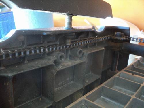

One more thing to check is that the chain drive underneath is unobstructed. 8iowa's comment made me think of this. If the planer gets set down hard on the way tube clamps, the threaded insert it screws into can be dislodged, jamming the chain. The chain will also be jammed if the drive side clamp is screwed in too far.
[ATTACH]12096[/ATTACH]
