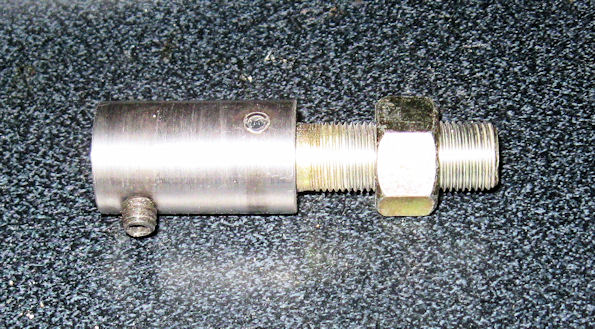

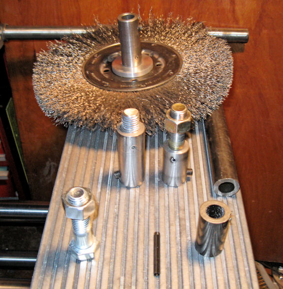

I do not see anything about homemade arbors when searching this forum, so thought I’d show what I have been doing. Proper Shopsmith arbors are rarely available locally, plus I wanted to mount some non critical items like polishing/buffing wheels and wire wheels (a couple of each) at minimum cost. I got some 5/8” bore heavy wall pipe and had a few 5/8”diameter bolts, so I cut the heads off the bolts and connected bolt and pipe with a ¼” roll pin; this is the result:
[ATTACH]12097[/ATTACH]
I do not recommend you use these for critical items like saw blades or grinding wheels where exact concentricity is important. It is useful to have a metal lathe to trim the ends of the pipe perpendicular. The portion of the bolt in the pipe does not have any threads. The roll pin extends right through both sides of the pipe.
The following arbor is 3.5” long, made up of a piece of the pipe 1.75” long and the bolt extends 0.565” into the pipe (leaving a socket 1.185” deep). The bolt without head was 2.315” long. The center of the setscrew is .375” from the end of the pipe. The roll pin is .3” from the other end of the pipe.
[ATTACH]12098[/ATTACH]
Works fine, especially since I am using them at slow speed.

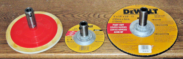

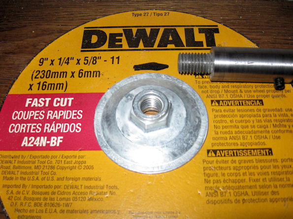

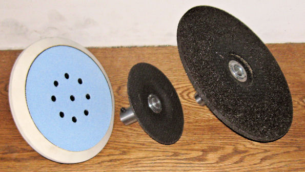

This week I was in our local Dewalt store and they had a 6" Porter Cable rubber backed and velcroed sanding disk, a Dewalt 5"x3/32"x5/8"x11tpi metal cutting disk and a 9"x1/4"x5/8"x11tpi metal sanding disk on sale for cheap, so I bought one of each.
[ATTACH]12228[/ATTACH]
Their center threads screw right on the arbors I have made using standard 5/8" bolts.
[ATTACH]12229[/ATTACH]
Now I have to see what to use them for.
[ATTACH]12230[/ATTACH]
[ATTACH]12231[/ATTACH]

Fortunately the pipe I got is a nice tight fit on the 5/8" SS spindle and the cut off bolts fit snug into the pipe so there is very little wobble.
The setscrews I use take the standard SS hex wrench.
Peter
"Heavy wall" pipe is just a term for pipe with a thicker than usual wall. You need a pipe with exactly 5/8" bore and a wall thick enough to give ample thickness to accomodate the set screw. A thin wall results in the set screw falling out when you back it off to remove the arbor from the SS. The pipe I used has a wall of 0.190", near as I can measure. I think the metal supplier had other even thicker wall pipe as well.
