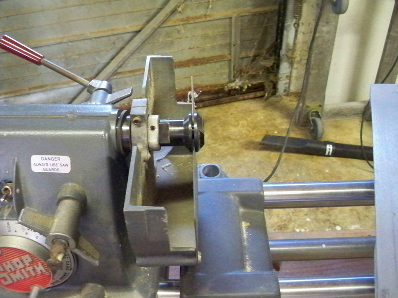

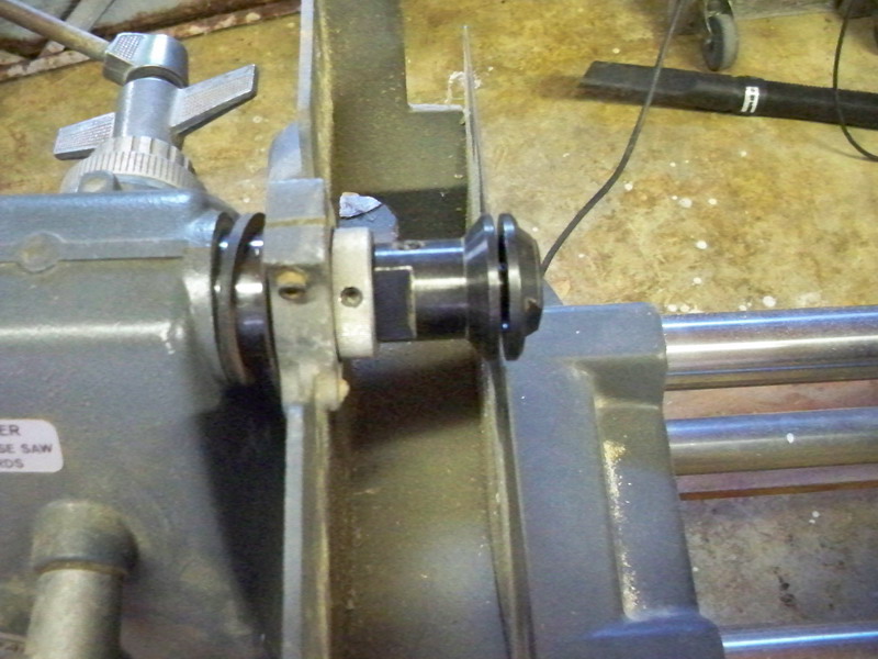

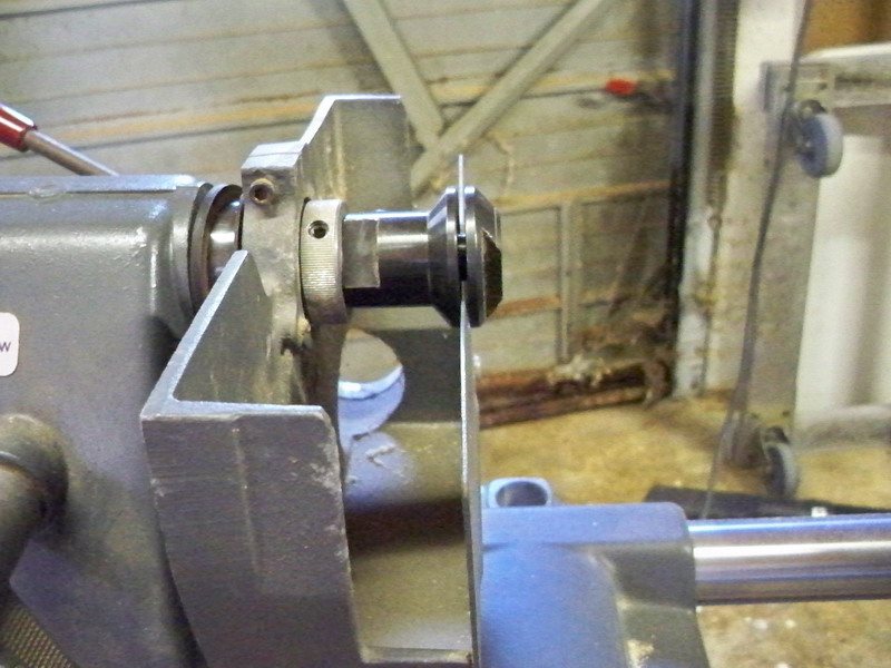

[ATTACH]12191[/ATTACH]I've been woodworking 20 yrs and just inherited a Mark 5. The lower blade guard was not attached but was included with the machine. When I attach the lower guard and then try to mount the arbor and blade, the blace would be perfectly aligned with the outside of the lower guard. I have tried for over a week to see what is wrong. Guess its time to ask for some more experience help. It looks like it would fit if I took off the silver aluminum collar but I don't think that's the problem. If it helps any, the serial number is 12183 and the model is 505644.

Welcome to the family. It is always good to gain another new member. I apologize for not jumping in here to answer your questions but I do not have that model and can not. The images that you show seem to show a different lower blade guard than I have.assembfurn wrote:[ATTACH]12189[/ATTACH]

Can you post an image of the name plate and serial number plate.
1) The arbor is the longer version intended to be used on a 505/510/520 model(larger tables etc.)
2) You have a 500(the carriage tells the tale) which requires a much shorter arbor. The blade is then actually inside the end of the quill shaft.
3) The important difference is that the blade is 3/8" closer to the quill end of the arbor on the shorter '500' version.
JPG40504 wrote:1) The arbor is the longer version intended to be used on a 505/510/520 model(larger tables etc.)
See post two.
beeg wrote:See post two.![]()
Hey! There IS a difference between 'I think' and 'is'.
The overall length(shorter) is not relevant to his problem. The quill end to blade spacing 'is'.
Also a difference between 'I believe you have' and 'you have'.
He needs to know the arbor is not intended for use on his model. The saw guard is just one problem using that longer arbor will create.
