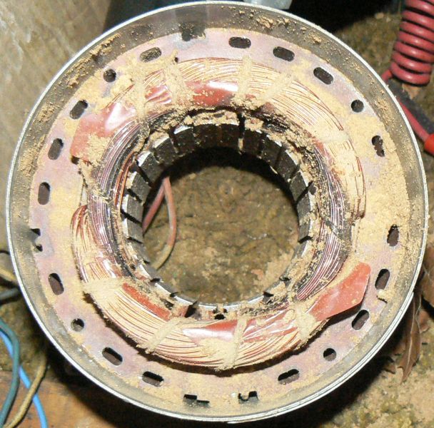

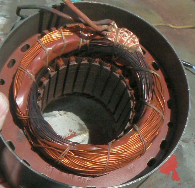

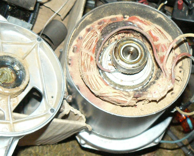

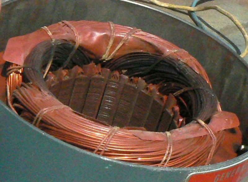

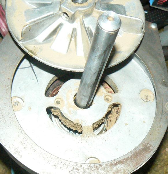

I have disassembled the motor John 'discarded'. It definitely had a 'burned' smell, but more like 'wood'. The bearings are 'rough' and the grease has migrated to the outside of them. They felt much better prior to disassembly(a bit of stress removing them from the housing). The start winding is 'scorched' and there are no shorts to the frame of the motor. Actually they are burned severely, but I do not think they are shorting(yet).
Pix follows:
[ATTACH]12564[/ATTACH]
Front before disassembly. Note internal sawdust accumulation.
[ATTACH]12565[/ATTACH]
Front internal.
[ATTACH]12566[/ATTACH]
Rear internal.
[ATTACH]12567[/ATTACH]
Rear burnt winding.(start)
[ATTACH]12568[/ATTACH]
Front burned winding(start)
The start winding measures about 3 ohms and the run winding 0.6 ohms.
Since those readings are normal(or at least reasonable), I will attempt to make it usable again. New bearings and some formvar gingerly applied to the scorched wires. I am hoping the thermal mass of the armature prevented more severe burning internal to the armature. Time will tell!
This motor is very close to being toast. The sawdust accumulation may have been a benefit it that the saw dust smoked first????
More later!:)
Post #5 this thread(5 min run) is indicative that it may be salvagable if not 'reliable'.
Make that 'stator', not armature!!!
