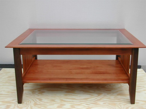

Here's a picture of the coffee table I recently delivered to a customer. He supplied the rough cut lumber cut from trees harvested from his father's land in Tennessee. The majority of the work was done using the Shopsmith (all jointing/planing, table saw work, cutting mortises, tenons, and rabbets).
I'm now finishing up the two matching end tables to complete the set.

Definitely work to be proud of. Beautiful!

Thanks to all for the kind words. This was a fun project to build and the big smile on the customer's face when he came to pick it up made it even better.
Scottss: I made the mortises with the SS Mortising Attachment. It worked well (even before I saw Nick's explanation of how to use it on the Sawdust Session). I cut the tenons with the table saw - just nibbled away what I needed to get a tenon that wouldn't "quite" fit and trimmed them with a hand plane to get a good tight fit. The taper on the legs was cut with a taper jig on the table saw. The plan showed how to build the jig - very simple - but you run the piece through the saw reversed from the way you would normally use a taper jig.
Ed: I used the plan from Woodsmith Magazine. If you want to know which issue let me know - I'll have to look it up.
Charlese: The top edges have a bevel cut on the outside bottom edge to give the table a lighter look.

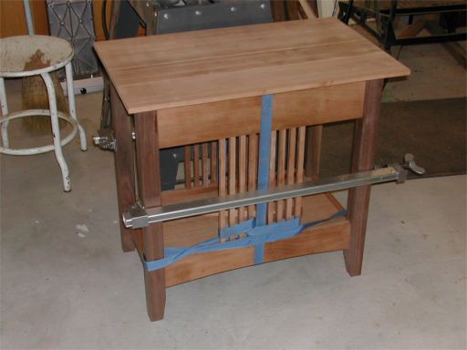

The end tables are nearly comlete. They are dry fit together right now. I still have a little "tweaking" to do to make the joints fit just right and then finish them. I've attached a picture of one of them in its current condition.
