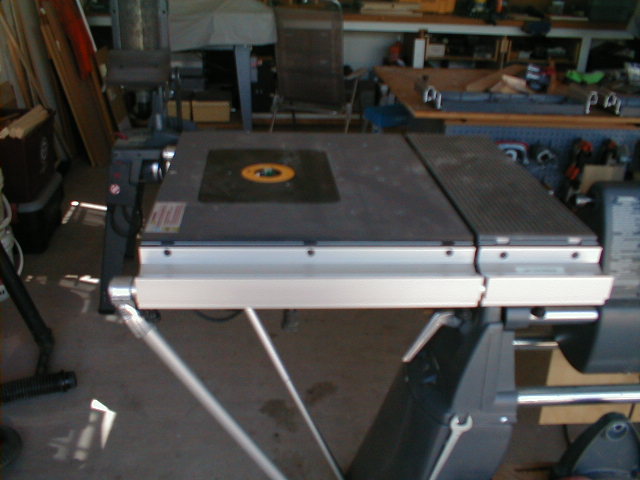

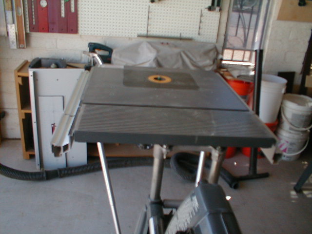

I have just installed a new router table (555995). I don't know why but it doesn't "feel" right.
Do I have it installed backwards?
Think about the rip fence. It seems like it'll be on the wrong side of the blade. Also the feather boards. In other words, is the front rail on the back of the table and the back rail on the front of the table. If I made that change, the table itself would be rotated 180 degrees.
The table is 555995 and not 555595. In the catalog, It does appear that the insert is centered in the table but it is not (as stated in another post/this thread).

dusty wrote:I have just installed a new router table (555595). I don't know why but it doesn't "feel" right.

From the picture it looks like the mounting plate is centered, is that correct?
Now I guess I don't know what seems wrong from your perspective. The fence would be on the oposite side of the bit from where you would stand... the bit between you and the fence. If you have the 521963 fence then you are all set. If you don't you will need to make something that will work like that does. Some how you have to be able to have the bit set with in the "fence".
If you don't have that fence then you will have to come up with something. As you might expect I have just the thing. I'm soaking my foot right now but in 20 minutes or so I can go and get the part and shoot a few pictures, it is not my design but came from the manual I got with my Incra system. It is not designed for the shopsmith but it should be easy to make it work.
Still soaking my foot but I was able to reach a catalog. When I look at the table number you gave me it looks different then yours. The one I'm looking at looks like it is centered both left and right and back to front. I'm also not seeing all the holes that yours has. Now I more confused then ever.

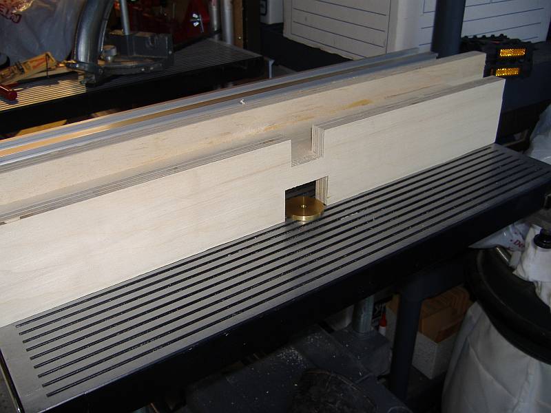

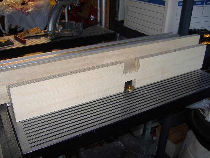

This is a fence that lets you have two fixed openings (it flips over to do that) that let cutters be mounted below it and yet away from the real fence. You can adapt it by having various opennings or maybe even a replaceable insert...
The brass part are there to show you where the bit would be. And of course this is on the shopsmith main table that it is sitting on and of course this is not a router table....

The insert is centered between the front rail and the rear rail but it is offset the other direction.
When I mounted this to the SS, I expected to stand off to the left end and face toward the headstock. In this position, the short side of the table is between myself and the blade. I think I want the larger side of the table between myself and the blade. Also, I think I want the feather boards between myself and the fence (pushing stock to the fence). The holes (there are eight of them) for the feather boards (I think) are on the far side of the blade.
Yes, if I rotated the table, I would have to exchange the rails.

You have the table swapped. The fence should always be behind the cutter in referrence to you and Feather boards should always be in front of the cutter in referrence to you.
Plus the large portion (working portion) is hidden behind the fence if you keep the table the way you have have it.
Take the fence rails off and turn the board 180 and reinstall them so the front rail is still the front rail. The if you mount the table on the left end of your machine you should stand to the front left side of the table/machine and feed toward the back.
If you mount the table on the right side you would then stand on right backside of the table/machine and feed toward the front.
