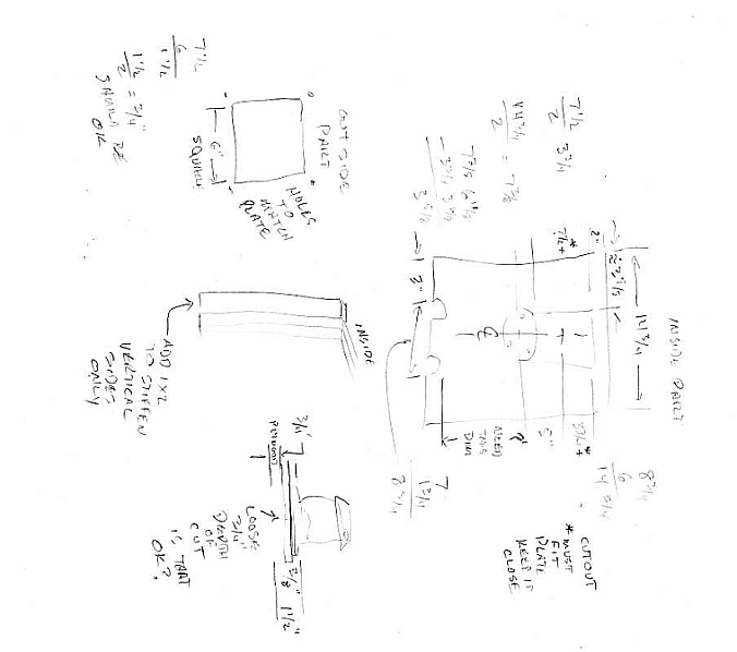

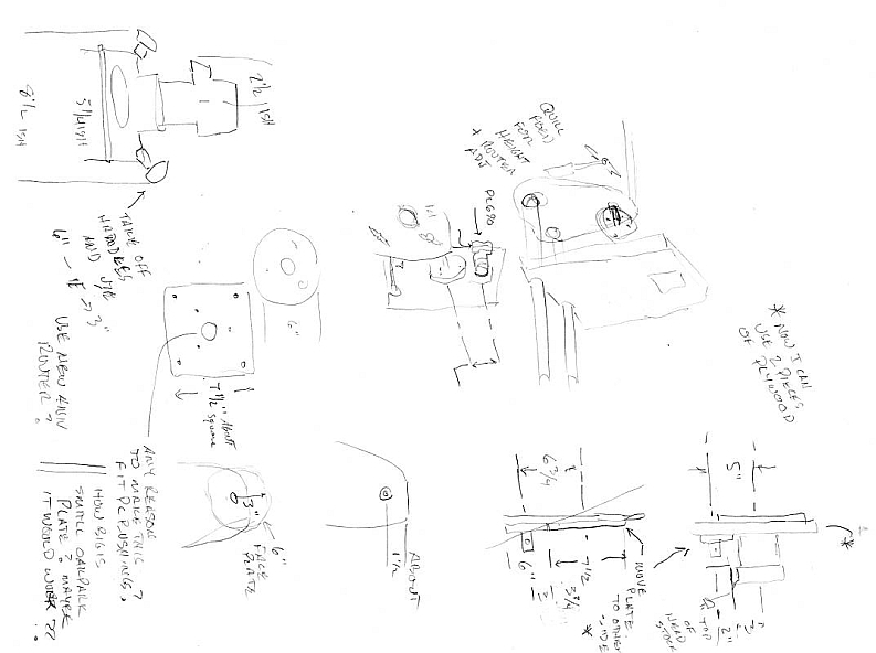

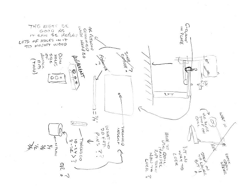

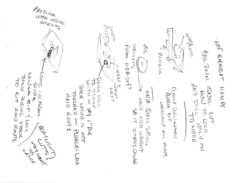

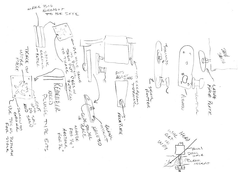

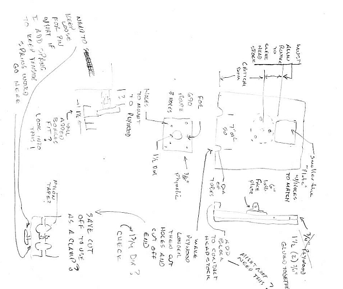

I have some sketching of something I built maybe about 10 years ago. I no longer have it and the sketches might not make a lot of sence but I'll dig them out and scan them in. The real plans were I'm afraid drawn on the plywood... a bad habit I have when do such things... so the real dimensions might have been adjusted for real life situations.
I wanted a pin router back when shopsmith use to sell them and this was my attempt to make one... by the time I had the money they had stopped making them. I should say one of several attempts. I also purchased a couple of over arm pin attachments for a table router. This was the best working of all of them but still felt short of what I wanted.
I personal think you need metal to get it ridged.
Sketches to follow.
Sketches to follow.
OK it took a while to find them and I even found the very first design that I tried to use. I actually did a project with it and learned a lot for the second go around.
These are going to be hard to read as they were only notes to myself. If you can't figure it out I'll try to help out but again this was a while ago. Just from reading what I wrote the second one was about a year after the 90 anniversary... I just got my second PC690 at a steal of a price because it was the old model in the black box with polished AL etc. Sears was getting rid of them for like 1/4 or 1/3 off.... I got one on my lunch hour and stopped in to get a second one after work but for some reason they were sold out.....
This was intended as a pin router but the idea is about the same so take a look if you dare. BTW I still do this sort of ideas/sketches while watching TV. I have a whole big stack of things that never got made and will not be the way life is going.

They don't look so good.
After these having to be sized and rotated to meet the 800 x 600 rule (why can't we have 600 x 800????), they are hard to see. If anyone really wants to see them let me know and I will post larger ones at the site where I post my pictures.
I also looked up Porter Cable and the 90th year would have been 1996, so plus one = 1997 and it is 2007 so it is 10 years ago!! See my memory is failing after all.
If anyone wants them it will be later in the day if at all as we are going to baby sit one of the granddaughter who is almost 11 months old tomorrow....... an 11 hour day that we enjoy but almost don't have the energy for anymore.
