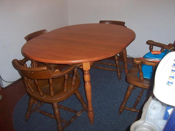

sambofl
Posts: 43
Joined: Tue Jun 05, 2007 10:59 pm
Location: Raised AZ, stationed in Albuquerque NM
Post by sambofl »
Well I finally finished restoring my wifes table after much delay and procrastination. Here is a pic of the finished project
Ed in Tampa
Posts: 5834
Post by Ed in Tampa »
sambofl wrote:Well I finally finished restoring my wifes table after much delay and procrastination. Here is a pic of the finished project
Looks fantastic how did you stripe off the old finish and what did you use on the new. Give us the details.;)
