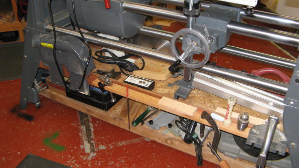

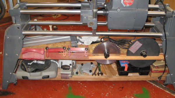

Here's what I use. Two shelves, not much to it. I have no plans, I just went along. Both shelves have two stretchers that go all the way to the legs. The upper attaches to the legs with threaded inserts. (Also the upper the stretchers are flush with the legs and I cut the groove that holds the shelf on a bevel.) The bottom shelf stretchers are notched and hang on the axles.
I change it every once in a while - poke a hole through for something or take something off that doesn't work. I find nothing more satisfying as making my SS more MY Shopsmith.
If you have specific questions feel free to send a private email. I'll help if I can.
[ATTACH]12699[/ATTACH]
[ATTACH]12700[/ATTACH]
accessory shelf 5.jpg (53.6 KiB) Viewed 5759 times
accessory shelf 9.jpg (57.46 KiB) Viewed 5717 times
