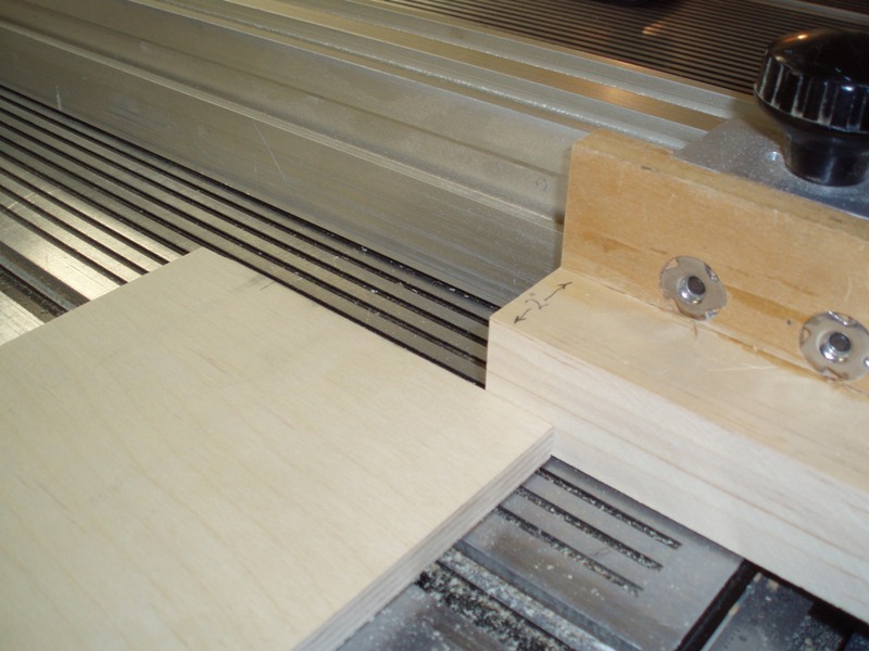

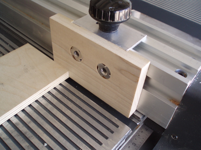

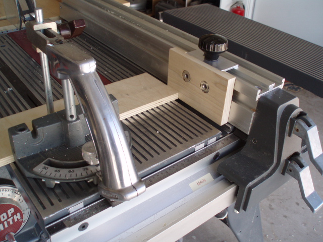

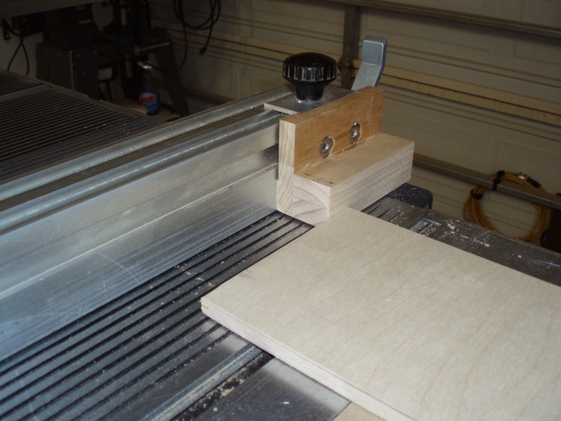

This is not a new subject but I decided to post it anyhow. We have discussed the hazards involved when one uses a Miter Gauge along with the Rip Fence to facilitate multiple crosscuts of the same size.
I have used the following device to do this "forever" but the discussions here convinced me that I needed to make a small change.
[ATTACH]12754[/ATTACH]
[ATTACH]12755[/ATTACH]
I have done that now with a simple modification.
[ATTACH]12756[/ATTACH]
[ATTACH]12757[/ATTACH]
When it is time to set the fence, the knob is loosened, the stop is moved up by the blade for measurement, the fence is locked, the stop is moved back and locked.
The rip scale can also be used if calibrated adjust the stop block.

I guess I should not be surprised.Ed in Tampa wrote:Okay I bite why is that safer?
http://www.shopsmith.net/forums/showthr ... light=kick

I assume this helps because it gives the cutoff room to move instead of being trapped against the fence is this correct? I am going to do this with my dedicated TS.

The cutoffs tend to walk a little and it doesn't take much. This gives a little more room. Just don't get in the habit of leaving cutoffs on the table.wannabewoodworker wrote:I assume this helps because it gives the cutoff room to move instead of being trapped against the fence is this correct? I am going to do this with my dedicated TS.
