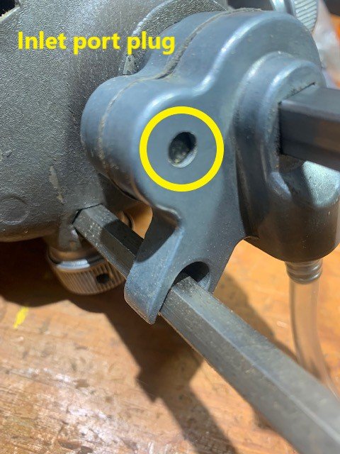

Depending on your jigsaw vintage I believe you may or may not have have the internal nylon check valves & springs. The 1960's version I was given has the air puffer intake valve port blocked with a rubber plug and no nylon check valves on either the intake or discharge ports so the puffer both blows and sucks, but is still able to clear the sawdust.
I'm guessing Magna engineers made this change after too many complaints of the original internal nylon balls with springs design clogging up (or the original owner removed them and put in the plug). My puffer performed much better after I reversed the leather cup so that it faced down rather than up, sealing on the down (puff) stroke & leaking on the upstroke, making the pump itself a simple check valve. Someone must have had it apart at some time and re-assembled it backward.
I experimented by removing the intake plug and replacing it with an external aquarium pump check valve oriented so air flow could only occur in (on the upstroke) and put a second check valve in the discharge tube to allow only blowing out (on the downstroke), but the cheap aquarium valves required too much pressure to operate and blocked off the air flow completely. I found some small spring loaded rolling ball check valves online that operate at lower differentials but didn't order them after I figured out that turning the leather cup the right direction improved the puffer performance.

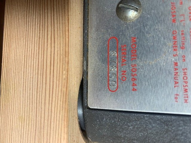

I'd be interested to hear from other jigsaw owners whether their saw has nylon balls & springs or the plugged version like mine and what the serial number is. My serial number is 87859 which dates my jigsaw to the early 60's.
jigsaw serial number.jpg (75.67 KiB) Viewed 2904 times

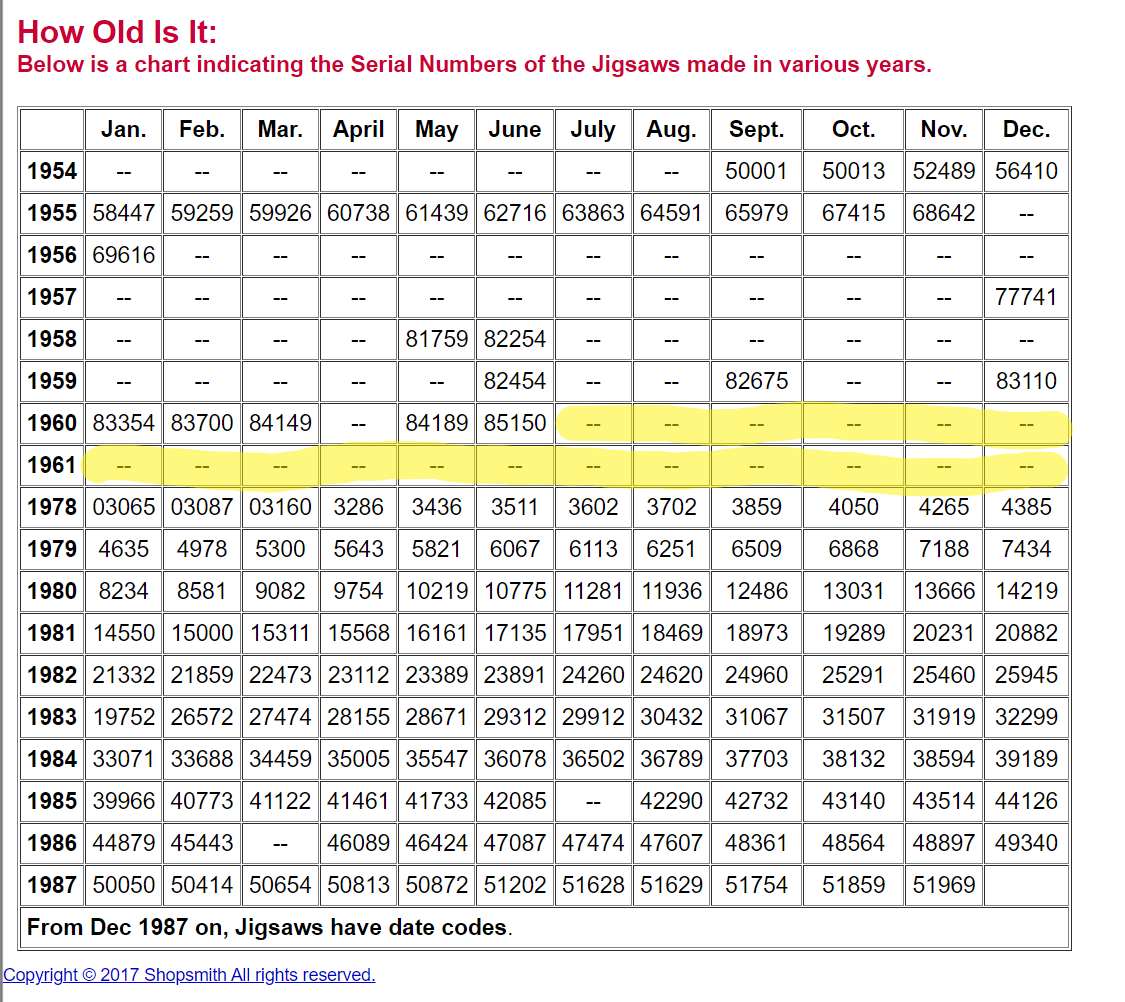

Jig saw serial numbers.png (215.6 KiB) Viewed 2904 times
- Matanuska

I am curious if you have had the Upper Bracket Assembly apart. Once removed from the cylinder the bracket can be separated and the check valve balls and spring can be seen.
Your Jig Saw having serial number 87859 and more importantly being Model Number 505644 would make it after the part number change in the beginning of 1964. It should be a Jig Saw made by Magna American Corporation. A look at the entire cover plate shown in your second picture of the serial number would confirm this.

Yes, I’ve driven out the pin, removed the UBA, and opened it to check & replace the gasket. The inside was empty except for the black rubber plug in the inlet hole. No nylon balls or springs.
Yes, its’s a Magna American model.
