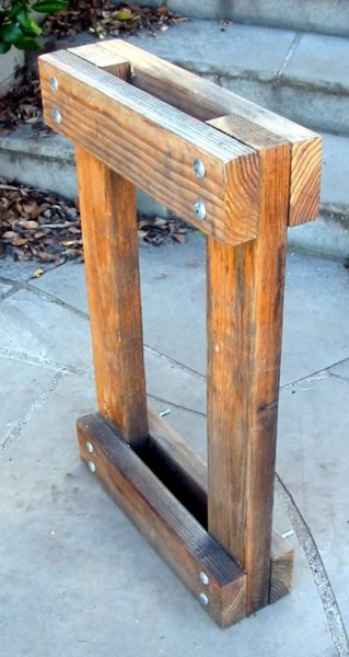

Press???? You would be surprised what you can accomplish with some 2x4's and a hydraulic bottle jack.
[ATTACH]12860[/ATTACH]
This has gotten a fair amount of use on motors and drive sleeves. I make hardwood accessories bored for the appropriate shaft size. So far so good.
