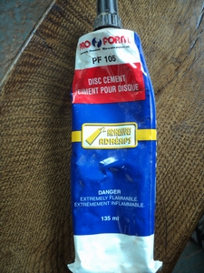

You could use this. I would still buy the unglued 6" 3M discs if I could. This stuff works better than the PSA glue and the dry discs were a lot cheaper. A little pass over the disc with a propane torch would always free a troublesome disc, but normally the heat of sanding keeps them peel-able. One application is good for around 10 to 15 discs.
[ATTACH]12924[/ATTACH]
