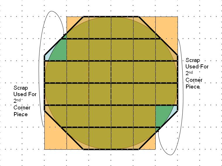

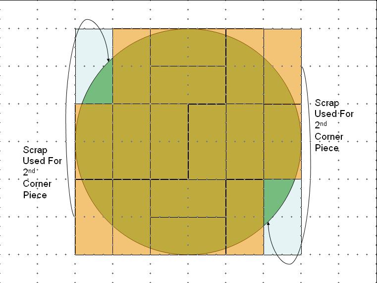

Attached is a power point of two configurations, first where you make it exactly round, and second where you do the 10' octagon. The second seems to make more sense as far as ease of framing it in because you have all straight edges. Attached are screengrabs of two powerpoint visualizations. The lightest pink areas are where the cutoffs would be. The drawings are to scale.
Hope this helps.
Hope this helps.

Pessen -That's perfect! Thank you.
One giant slice of tree, hmmm, let me know when you find that ok:rolleyes:
The wood will be placed on top of a sand base, with the sheets of plywood butted together over 2 x 4's so the weight distribution should be ok.

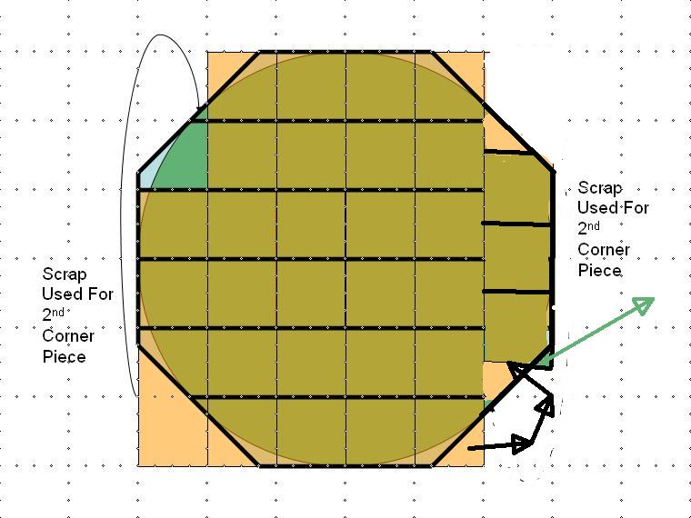

Crudely edited, but my thoughts! Duplicate bottom right corner for all four corners.
[ATTACH]13025[/ATTACH]
- Pool_Base_Octagon 2.jpg (52.1 KiB) Viewed 1421 times
