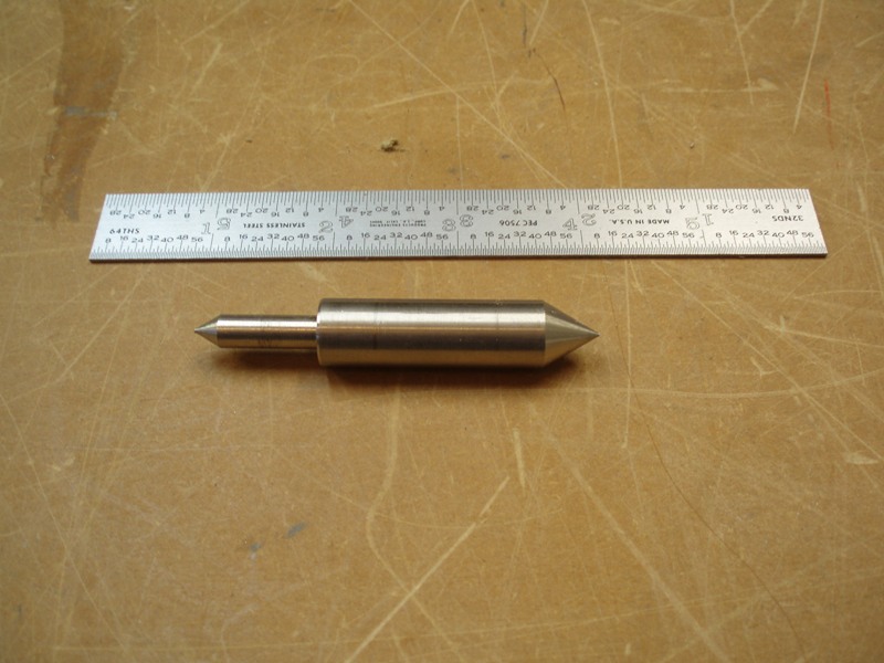

Since I have not been a turner, I have not given this much thought. However, when I read this post it reminded me of this tool from Woodcraft. It is used for center collets in routers. It might work.

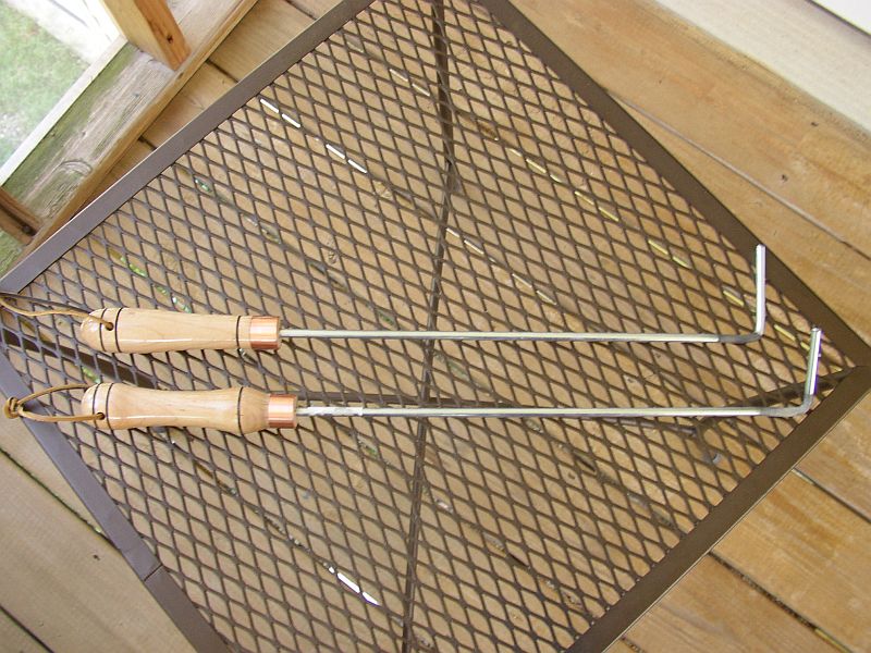

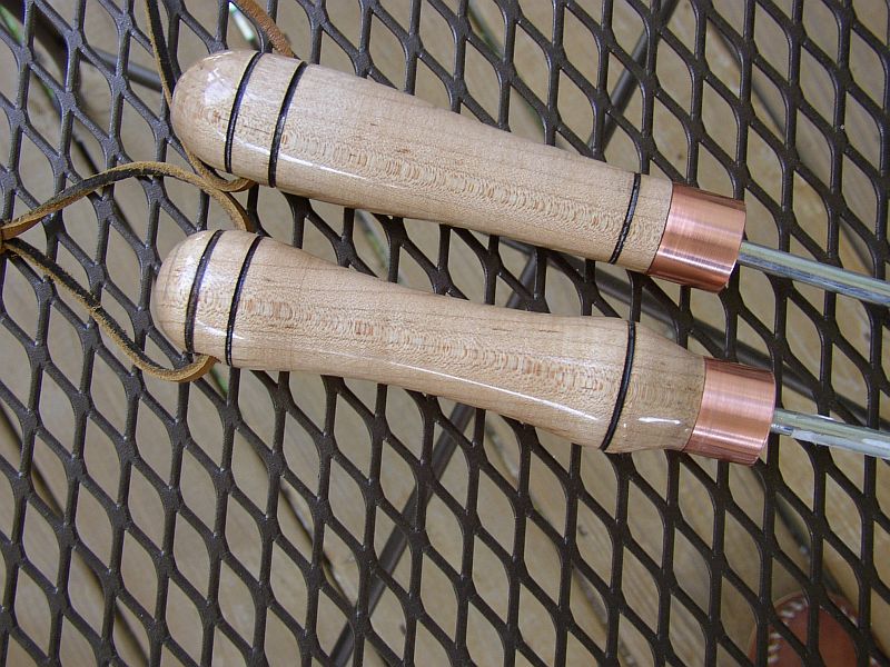

These are the wiggle rods I made and which sparked me to ask the question about aligning the lathe centers. The alignment process using a brad point bit worked great.
The handles are turned from maple, the ferule is a 3/4" copper coupling cut in half and the rods are 1/4" steel rods bought at HD. Finish is several coats of CA sanded and polished.
