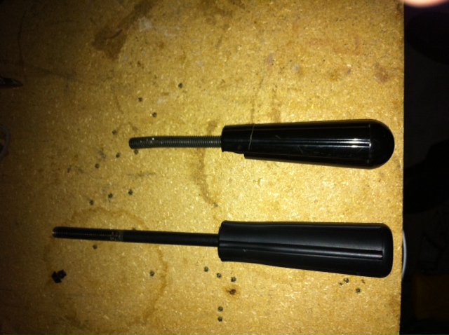

My bandsaw fence got away from me and did a dance across the garage floor. The handle broke and I sent off to Shopsmith for another.
When it arrived it wouldn't screw into the fence. It seemed like either the thread diameter was a bit too big or the pitch was wrong. Anyhow, rather than mess with sending it back (when SS was at the worst of their layoffs), I waited a few months and ordered another. It just arrived and it too wouldn't screw in properly.
I called Shopsmith and spoke with a CSR (guy- Dave?) who was uncharacteristically unhelpful. He didn't seem to know if there were two different types. He suggested that I look the part number up in the manual. Of course I don't have the original manual, as this was an ebay purchase.
Anyhow, Does anyone know if there truly are 2 models of handle and have a part number or source??
Attached is a photo of both. The broken handle is the shorter one. The replacement is the longer one.
Thoughts??

Your broken/bent handle is from the 'original' bandsaw fence(no rear clamp). The 'replacement' sent is meant for the newer 'upgraded bandsaw fence'.
Yes there are two versions.
The older one(the one you need) is threaded all the way up to the plastic handle and is shorter. The newer one is longer and is not threaded all the way to the plastic handle.

According to my 'manual' this is the part you need.
http://www.shopsmith.com/ownersite/item ... =Find+Item
If that price is 'correct' I would be making one out of 5/16-18 all-thread and 'make' a handle!
Thanks soooo much! That is the information that I needed. No way I'm paying $60 for a handle. I think I'll work on "Plan B" and will update the post when I'm done.
