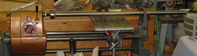

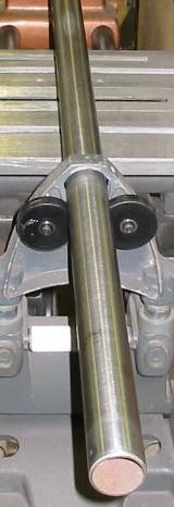

Tube Cleaning
I machined an adapter plate to fit a metal lathe chuck on the 5/8" quill shaft. When using a SHORTY, if the tube is bent, vibrations can be out of control and dangerious. I find about 25% of the tubes are bent when using this setup.
[ATTACH]13163[/ATTACH]
[ATTACH]13164[/ATTACH]

- IMG_0713.JPG (34.86 KiB) Viewed 2800 times
- IMG_0714.JPG (20.11 KiB) Viewed 2806 times

If you replace the ER way tubes with 10' tubes, how are you going to support the 52" way tubes on the extended ER for polishing? Mount a tailstock/support on the table/carriage?

I plan to put the head stock near the end so the weight of it is supported by the base supports. then I have a part that looks like the one in the picture of the shorty which I believe is a center point holder for the lathe. I will set it up to end of the way tube with a inserted expansion plug. that will be on a bearing and attacked to the center point housing.
I will also put a expansion plug in the drill chuck and then turn the way tubes like on a lathe.
"Jerry! how many times do I have to tell you! Lick that knife before you put it back in the butter!" ..... Jerry Clower's Mother.
Good luck finding a 1 3/8" plug!;)Shop_Smith_Poppi wrote:I plan to put the head stock near the end so the weight of it is supported by the base supports. then I have a part that looks like the one in the picture of the shorty which I believe is a center point holder for the lathe. I will set it up to end of the way tube with a inserted expansion plug. that will be on a bearing and attacked to the center point housing.
