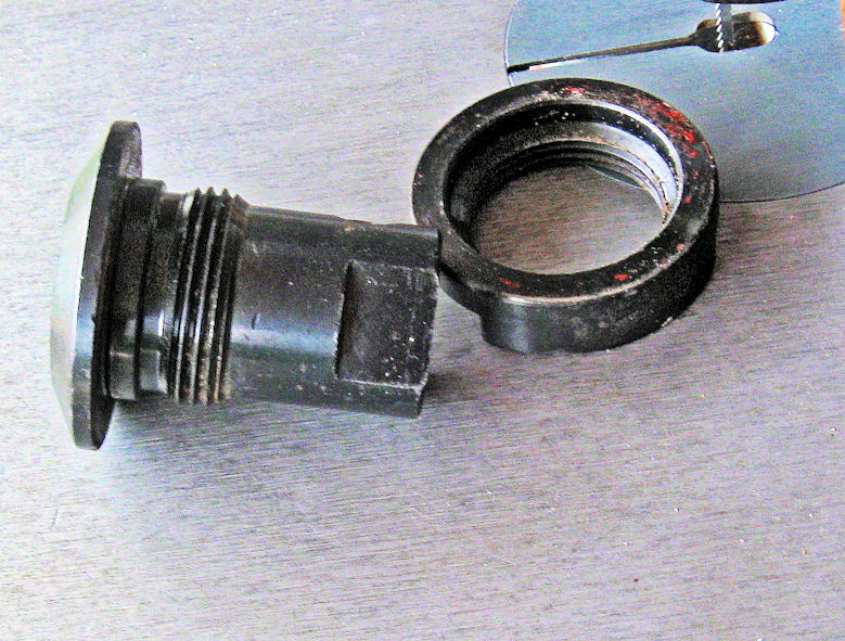

Take a look at this typical saw arbor:
[ATTACH]13222[/ATTACH]
The shoulder is 31.75mm (1.25") o.d. and the thread is 31.57mm (1.243") o.d. You would have to take the tops off the thread to get the blade on. Sorry.
Peter
