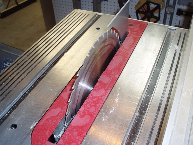

I must congratulate Shopsmith on this business decision. I want to believe that the idea for this riving knife came from the Shopsmith Forum. I developed my own a couple years ago because of forum discussion.

It says "not for use with through cuts" but can you anyway? I would assume so.

tomsalwasser wrote:It says "not for use with through cuts" but can you anyway? I would assume so.
You could just like you could go without a riving knife all together. That might not be the safe thing to do though.
In this era of law suits, Shopsmith must do what is safe (from a legal point of view) for them. They do not recommend that you use this version of the riving knife for other than non-through cuts. The upper saw guard is available and "should be used" for all cuts other than non-through cuts.
I built my own short version of the riving knife and I use it whenever I do not have the upper saw guard installed (for non-through cuts, etc).

Please, do not throw the upper saw guard under the work bench and just use the new one because it is so convenient! The new one does virtually nothing for preventing kickback during a through cut.
