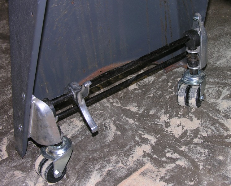

ldh
Posts: 430
Joined: Sun Sep 10, 2006 6:09 pm
Location: Phoenix, AZ
Post by ldh »
These work well for me.
ldh
[ATTACH]13354[/ATTACH]
Posts: 35457
ldh wrote:These work well for me.
ldh
And there are those 'mysterious' 'runny rust stains' again!:confused::confused::confused:
