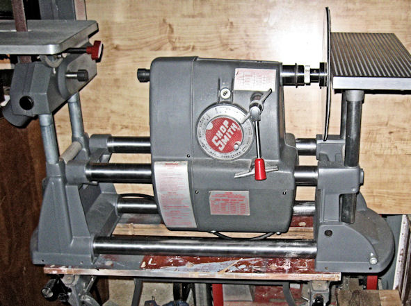

Last year I described a dedicated SS drill press here: http://www.shopsmith.net/forums/showthr ... rill+press
I used some non Shopsmith 1-3/4" pipe x 51.5" long for the way tubes but found the head hard to adjust because the pipe was a tight fit and I had to use a hydraulic jack to lift the head, which worked ok but I was not satisfied with it. I bought a couple of SS way tubes off Ebay to replace the originals, and by counterbalancing the head with some cable, pulleys and cast iron weights (not pretty though :) ), can now lift the head by hand. So I ended up with two 51.5" surplus pipes. I had also a spare head and two base castings so I decided to try making a mini today.
I started by using the forum search to get some advice. I then cut each 51.5" pipe to 25-3/8" and 26-1/8" which maintains the required 3/4" difference between way and base tubes and made a legless mini that sits temporarily on a workmate. The head slides ok now that I don't have to lift it. Here is a picture:
[ATTACH]13418[/ATTACH]
Peter
prmindartmouth wrote:Last year I described a dedicated SS drill press here: https://forum.shopsmith.com/viewtopic.php?t=6925&highlight=powered+drill+press
Ya done good! I think with legs(or permanent mounting) ya gonna really like it!
