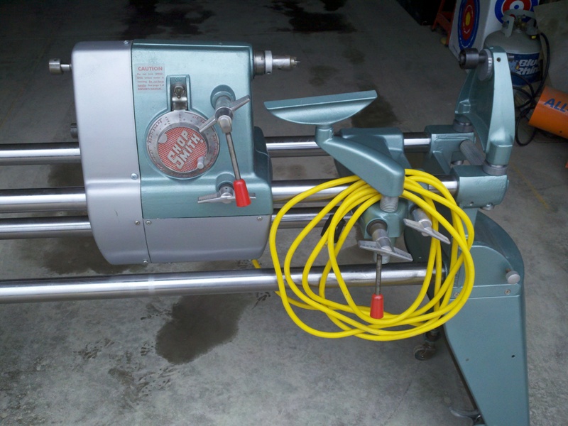

I have just returned to some wood working with my older (1980's) Shop Smith V. Earlier I had a question posted on here about centers.
In the meantime, I have purchased from SS two centers, a Lathe Drive Center (Item 505715) and a Lathe Cup Center (505716). In the attached picture, the latter is the shown as "B".
However, having received the Lathe Cup Center, I have no idea where/how it attaches to the SS. As you can tell I am an neophyte. I appreciate any help. Thanks.

It slips into the lathe tail stock (it's kind of horseshoe shaped with legs and a hole in the top).
There is a round piece that fits into the tail stock with numbers on it and a hole in it. This round piece is held in place by a setscrew once you get your drive center and cup center lined up.

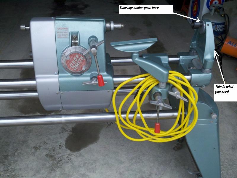

Here is a pic of my shopsmith with the tail stock attached it's on the far right and has the live center installed. Yours goes in the same spot

[ATTACH]13447[/ATTACH]
No fair making fun of my less than stellar picture editing skills.:o

jcraigie wrote:[ATTACH]13447[/ATTACH]
Are you also dyslexic? My tailstock is on the right!.:D Same as in yer pix!;)
Pix looks purty good to me!
BTW NICE looking early(A headstock) greenie!:cool:

tadd
Silver Member
Posts: 13
Joined: Tue Jun 07, 2011 11:05 pm
thanks
Post by tadd »
Thanks for the helpful info. I was unaware that that part was able to be changed out. By tapping it on the garage floor, I was able to disengage the center that was there and insert the new one. Again, thanks.
