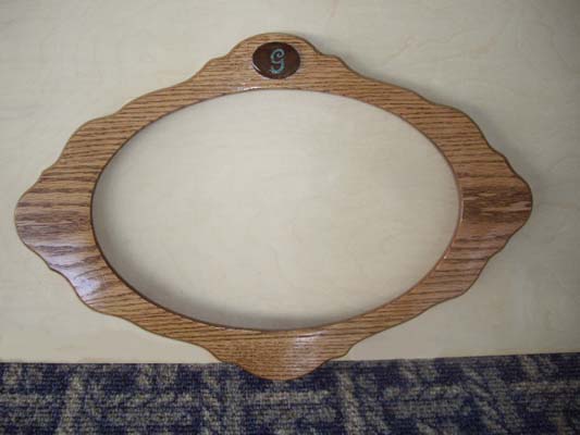

This is one of four.
Oak and walnut w/ turquoise inlay.
Frame cut out with the over arm pin router.
Inlay cavity was scroll sawn in 1/8" walnut.
4 applications of BLO, mineral spirits and poly mixture.
Final step will be Carnuba wax.

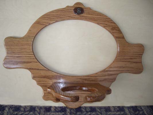

This is one of two. Same as above.
Awaiting coat hooks either side of the mirror.
The pot holder is sized for an 8" flower pot.

beeg
Posts: 4790
Location: St. Louis,Mo.
Post by beeg »
GOOD looking frames there Gene.
beeg wrote:GOOD looking frames there Gene.
AGREED!!!!
Any reason for the 'open' front on the pot holder?
h-bomb
Posts: 53
Joined: Wed May 18, 2011 10:12 am
Location: Sandford-on-Thames Oxford England
Post by h-bomb »
Nice!!!!!!

Thanks guys!
I think I figured out how to get an inlay strip to border the mirror opening. That's for the next ones, though.
Gene

JPG40504 wrote:AGREED!!!!
No reason. If there was when I made the template, I can't remember it now.:o
Gene

Gene Howe wrote:No reason. If there was when I made the template, I can't remember it now.:o
I resemble that remark!:D:eek:
Sorta! At least I think so, but I can't remember for sure!
JPG40504 wrote:Any reason for the 'open' front on the pot holder?
When I made a couple of mirrored oil lamp holders the "pot holders" had an open front so the lamp could be slid in the front. If a Pot had a narrow lower neck with a splayed base (skirt), this is the only way to put the pot in the holder.
