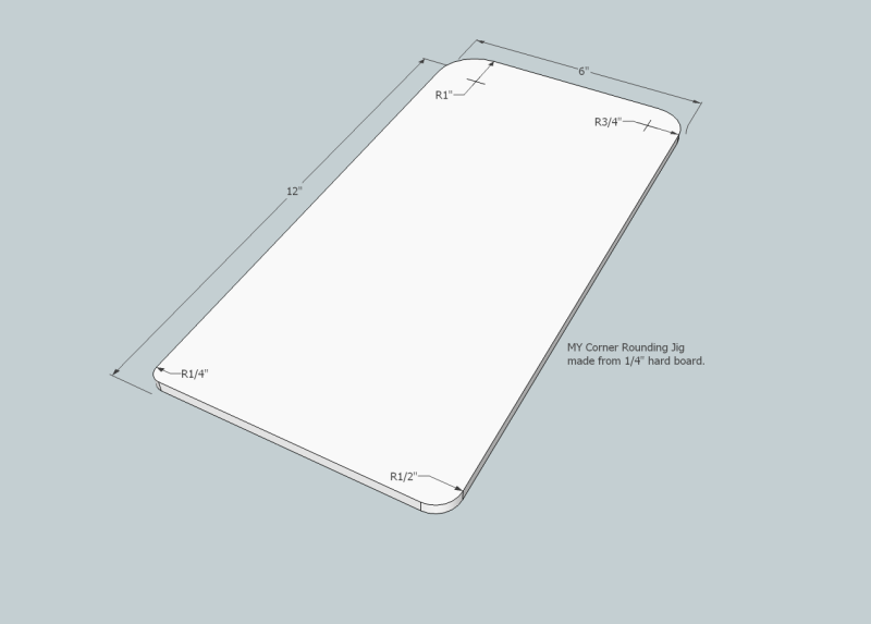

[ATTACH]13522[/ATTACH]

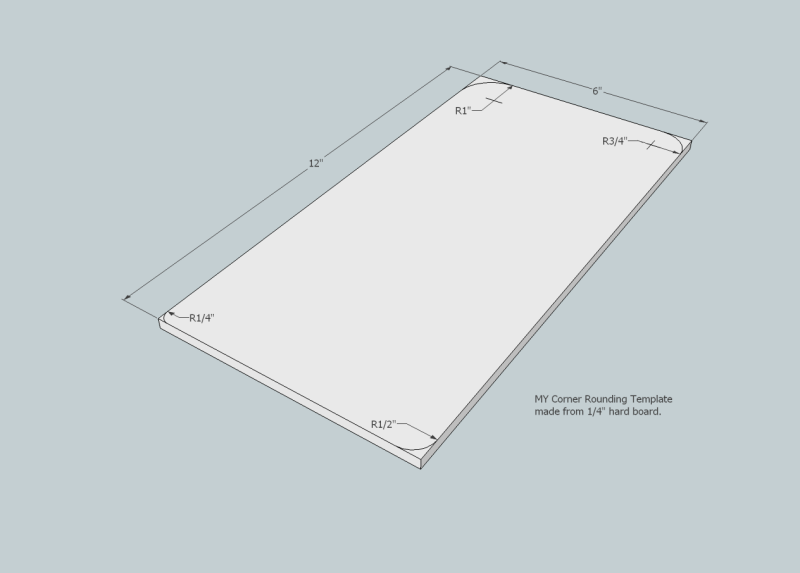

[ATTACH]13523[/ATTACH]
This jig is simply clamped in place on the piece to be routed using a straight pattern bit.
If anyone needs one of these, they are readily available for a mere $24.99 plus shipping OR check the pile where you deposit all your cut offs.
- Round Corner Template, Layout.png (47.2 KiB) Viewed 3419 times
- Round Corner Template, Finished Jig.png (45.28 KiB) Viewed 3419 times
Somewhere in my shop I have a piece of 3/8 plywood that has a different radius curve on each corner. The piece is about 12" square. I put the appropriate radius at the corner of the piece that I want to round the corner on and line the straight sides up on the project part. The sides are long enough to put clamps on to hold the template in place. The project piece then can be rounded using a piloted bit in a router. CHEAP!!
